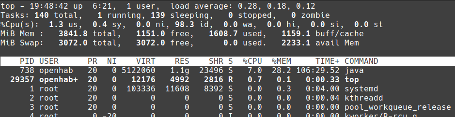

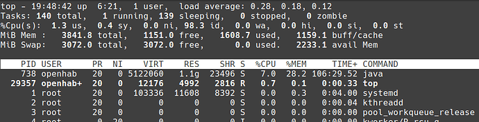

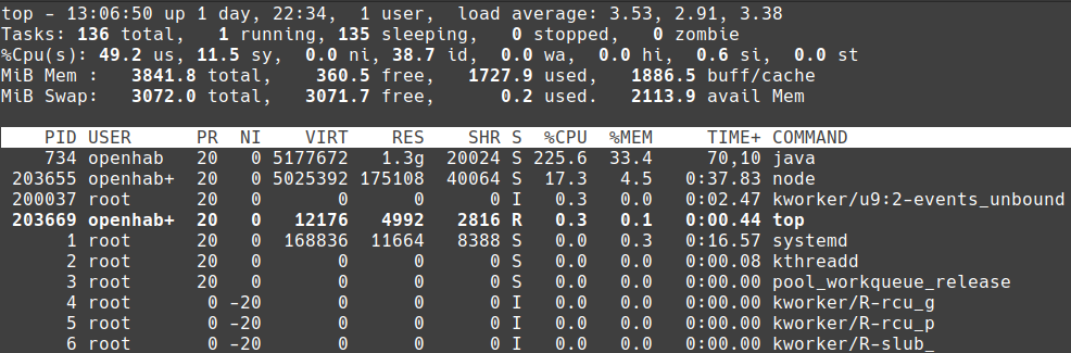

I did reboot the RPi and for several hours it was like this:
Now we’re back to CPU usage < 200%
I will restart again but rebooting the system two times a day cannot be the solution. :frowning_face:
