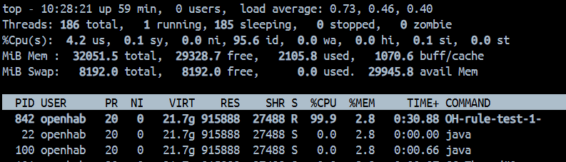

  5. Run top -H -p PROCESS_ID with the process id of openhab. There should be a rule thread that is now using up a whole cpu core.
Here is a screenshot from top:
