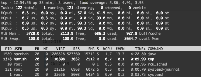

Were there any updates to this? I have just moved my openbhab2 instance to a R-Pi-4B (4GB). And for some reason this kicked in on mine as well (And I don’t use mapdb for persistence myself, I use mariadb).
fatrace doesn’t (currently) work on my Pi-4 (Looking into that now), so I can’t see what it’s doing, but I don’t believe it’s anything in cache or tmp (As I have those on tmpfs) but it pegs at least 2 cores (Sometimes all 4) at 99.9% WaitIO - And of course everything becomes very stodgy at that point as there’s no bandwidth left for diskIO for anyone else.
Oh… It’s not consistent either. Just after snapping the above, it returned to 98% idle on all 4 cores again. It spends a bit like that then lots of waitIO again for a bit… then idle… etc..
