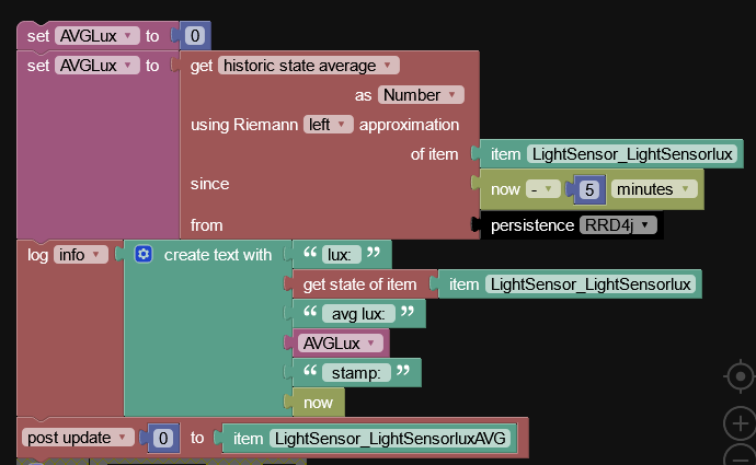

I have a simple rule which after update light sensor lux is updating average item in this thing as following:
Soemtingh wrong is with function - historic state average / persistance. I observe this problem after migration to OH 5.1.0 :frowning:

What is wrong here?
I think I’ve found a solution, so I’m sharing it with the community. It’s just a shame that such important information isn’t communicated in any special way with the new version of OH…
According to the information:
Note
openHAB version 5.1 and above no longer support default strategies. If you have a Default under Strategies you should remove it. Also make sure every Items definition has one or more strategies defined.
Persistence
So I defined a new strategy and it seems to be working.
