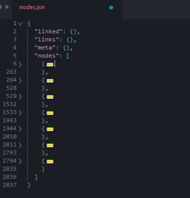

  4. Open the nodes.jsn file. It may be helpful to use something to ‘prettify’ and format the JSON, so that it is easier to read. If your text editor does not do this, there are online sites available that do this. nodes

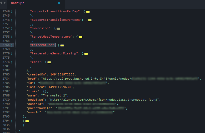

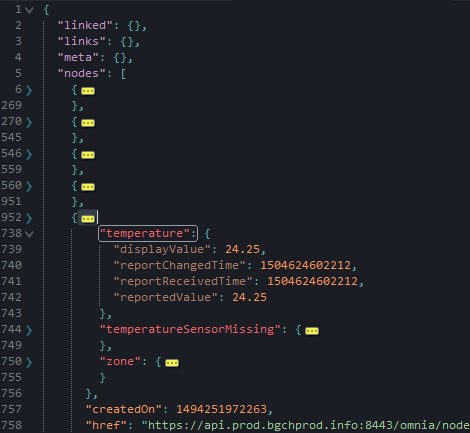

  5. Search for the exact text "temperature": including the quotation marks and the colon mark. It should only find one instance of this. The node that this is found in is your heating node. Scroll down slightly and you should see the “id” value. This is the id you need to enter in the RECEIVER_ID_HEATING parameter of the config file.
    temperature
  6. Before moving on, scroll UP and count the node number that this ID is found in, starting at zero for the first node. In the screenshot below, you can see that my heating temperature reporting node is node 4.

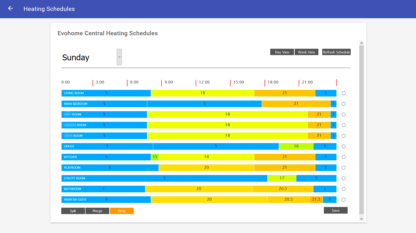

I have moved over to a Honeywell evohome solution (mainly because it gives me greater control over heating in each room with its up to 12 zones, and also because of its zone by zone ‘learning’ of heat-up/cool-down times). And yes, this is fully managed through openHAB.
Here’s a screenshot from one of my openHAB pages:
dayView
Is this screen shot the evohome app or OH?
If it is OH can you share you code for it, please?
