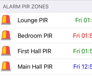

I built this to get the last date/time of each PIR (passive infrared sensor) that is hooked up to my home alarm system (plus uses rr4dj graphing for historical purposes) into OpenHAB. This could be handy to supplement home presence (although can’t be solely relied upon). Its one of those things that I built for the hell of it, but actually have found it quite handy at the times I’ve been out of the house…
https://cdn.instructables.com/FLH/V79U/J9EH1WCA/FLHV79UJ9EH1WCA.MEDIUM.jpg
Feedback would be welcome!

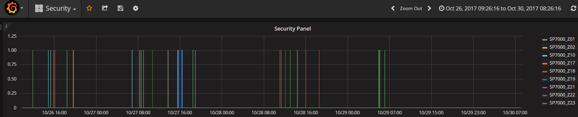

by the way, I am using Grafana to display the PIR motion events:
Graph
All PIR’s on one graph, nice - much better idea! Plus Grafana is a damn sight better looking than rrd4j graphs! I must update to it soon…!
