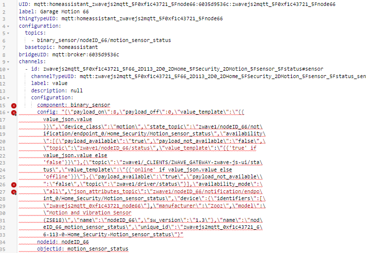

I have been testing some HA configs from Zwave-js-ui. They work fine with one exception, they are displayed on the UI code tab with errors. The impact is that changes (like removing a config) can’t be done. I had to delete the thing and rescan to pick up the changes. My guess is that the config is split-up to fit a certain field size on the UI code tab and that causes the errors.
The errors are;
  1. all collection items must start at the same column
  2. Nested mapping are not allowed in compact mappings
  3. Implicit keys must be followed by map values
  4. Implicit map keys must be on a single line
Sorry for the picture, but the point is that the HA config
was pulled directly from MQTT (this was one line).
{"payload_on":8,"payload_off":0,"value_template":"{{ value_json.value }}","device_class":"motion","state_topic":"zwave1/nodeID_66/notification/endpoint_0/Home_Security/Motion_sensor_status","availability":[{"payload_available":"true","payload_not_available":"false","topic":"zwave1/nodeID_66/status","value_template":"{{'true' if value_json.value else 'false'}}"},{"topic":"zwave1/_CLIENTS/ZWAVE_GATEWAY-zwave-js-ui/status","value_template":"{{'online' if value_json.value else 'offline'}}"},{"payload_available":"true","payload_not_available":"false","topic":"zwave1/driver/status"}],"availability_mode":"all","json_attributes_topic":"zwave1/nodeID_66/notification/endpoint_0/Home_Security/Motion_sensor_status","device":{"identifiers":["zwavejs2mqtt_0xf1c43721_node66"],"manufacturer":"Zooz","model":"Motion and Vibration Sensor (ZSE18)","name":"nodeID_66","sw_version":"1.3"},"name":"nodeID_66_motion_sensor_status","unique_id":"zwavejs2mqtt_0xf1c43721_66-113-0-Home_Security-Motion_sensor_status"}
Can anything be done or are there UI constraints?
Those aren’t UI specific errors, those are just yaml parsing errors. A lot of that comes from the : in the json string. You need to use a format that explicitly defines that whole thing as a string instead of potentially more yaml (which is what it is currently trying to parse it as).
If it were smaller I would just say enclose the whole thing in an outer layer of single quotes, but for something this long, to improve readability, I would suggest using one of the yaml block identifiers, | or >. For example:
config: >

I think the root cause here is that naked JSON is not compatible with YAML but the conversion from JSON to YAML doesn’t know it needs to convert the config property from JSON to YAML too. For most other Things, I bet it’s not JSON and doesn’t need conversion to be compatible with YAML.
I can see that they tried to make the JSON be a string with the addition of the " at the beginning and end of the JSON, but because the JSON itself uses " that completely messes it up.
I’m not sure what the best approach is to fix this but do know the solution will either be on MainUI or openhab-core, not on the binding.
I’d start with MainUI with a title of something like: “Thing YAML code fails if config contains JSON”.
