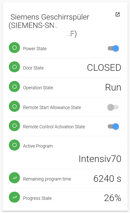

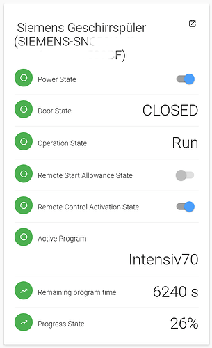

could you please remove the old device and add it afterwards. dishwasher_remote_start_allowance_state is the name of the old channel. I’ve renamed all channels. Please also refresh your browser before adding the device again. I encountered a similar issue. The Browser is using the old channels names during creation. Or you could try using another browser.
ok, it is working now, thanks. However, the log warnings seem to be a little misleading. I still got the following in the log:
2018-08-27 19:54:36.652 [WARN ] [dler.AbstractHomeConnectThingHandler] - [SIEMENS-SX878D16PE] No handlers to update channel "selected_program_state" found!
2018-08-27 19:54:36.732 [WARN ] [dler.AbstractHomeConnectThingHandler] - [SIEMENS-SX878D16PE] No handlers to update channel "selected_program_state" found!
2018-08-27 19:54:36.817 [WARN ] [dler.AbstractHomeConnectThingHandler] - [SIEMENS-SX878D16PE] No handlers to update channel "remaining_program_time_state" found!
2018-08-27 19:54:36.817 [WARN ] [dler.AbstractHomeConnectThingHandler] - [SIEMENS-SX878D16PE] No handlers to update channel "program_progress_state" found!
2018-08-27 19:54:36.901 [WARN ] [dler.AbstractHomeConnectThingHandler] - [SIEMENS-SX878D16PE] No handlers to update channel "remaining_program_time_state" found!
2018-08-27 19:54:36.903 [WARN ] [dler.AbstractHomeConnectThingHandler] - [SIEMENS-SX878D16PE] No handlers to update channel "program_progress_state" found!
2018-08-27 19:54:37.374 [WARN ] [dler.AbstractHomeConnectThingHandler] - [SIEMENS-SX878D16PE] No handlers to update channel "selected_program_state" found!
2018-08-27 19:54:37.461 [WARN ] [dler.AbstractHomeConnectThingHandler] - [SIEMENS-SX878D16PE] No handlers to update channel "remaining_program_time_state" found!
2018-08-27 19:54:37.462 [WARN ] [dler.AbstractHomeConnectThingHandler] - [SIEMENS-SX878D16PE] No handlers to update channel "program_progress_state" found!
The channels are working however, but they only seem to get populated once the appliance is on and not in standby. Probably that is why those misleading log entries appear when the appliance is in standby?
