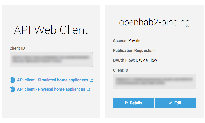

Hi Stefan,
is there a verification url at all? Can you please post your application config at the Home Connect developer site (you can blur the access tokens etc.)?
Thanks,
Jonas
Hi Jonas,
a verification url I don’t see. What I have now is:
Cheers
Stefan
Hi Stefan,
looks good so far. Could you please post your curl requests and responses (please remove or change the client id etc.)?
Thanks,
Jonas

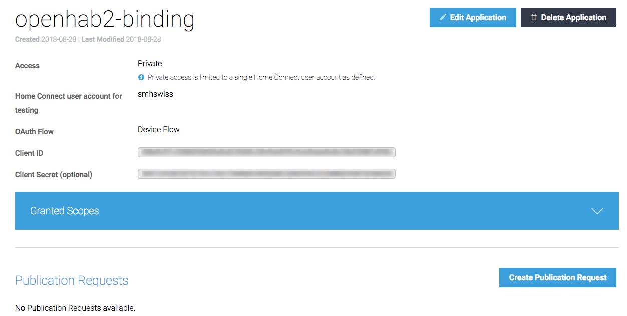

Hi @smhaller,
Strange just tested it with my account and it worked.
One thing I’ve noticed. In your posted screenshots openhab2-binding settings, the Home Connect user account for testing is not an email address. I had to use, like in the mobile app, an email address.
Greetings,
Jonas
Hi Jonas
I’ve got it working! Earlier it was possible to login with a username that was not an email, meanwhile this seems to have changed. And as the opening form check for a valid email address (not a username) it failed to authenticate. So I changed the details accordingly.
Stefan
