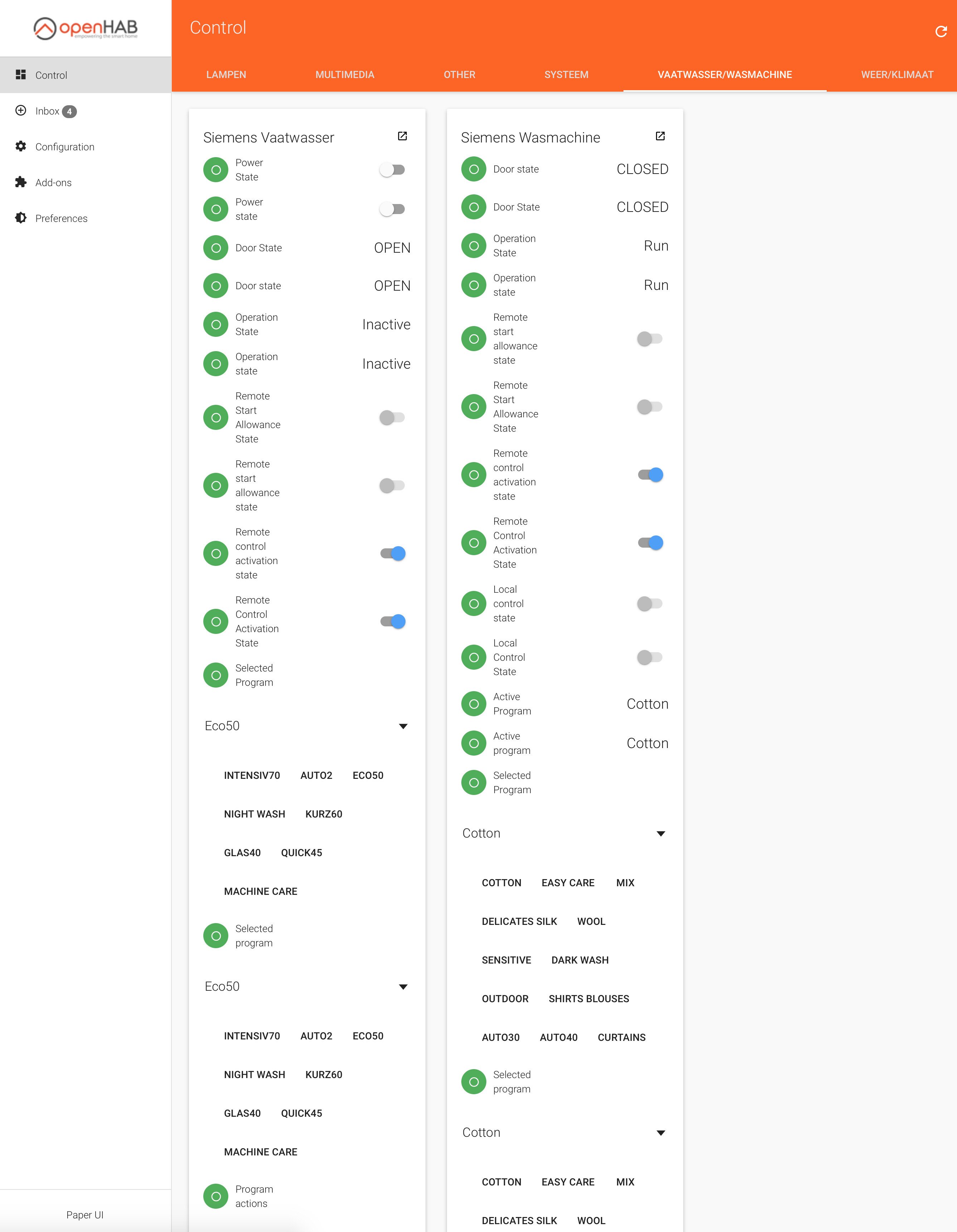

Hi @jb4711,
Thanks for looking in to this. I find something else, when going to paper ui → control, everything setting from the appliance is double. Do you have this as well @Pascal_S?
Not seeing this at my end @Lodewijk

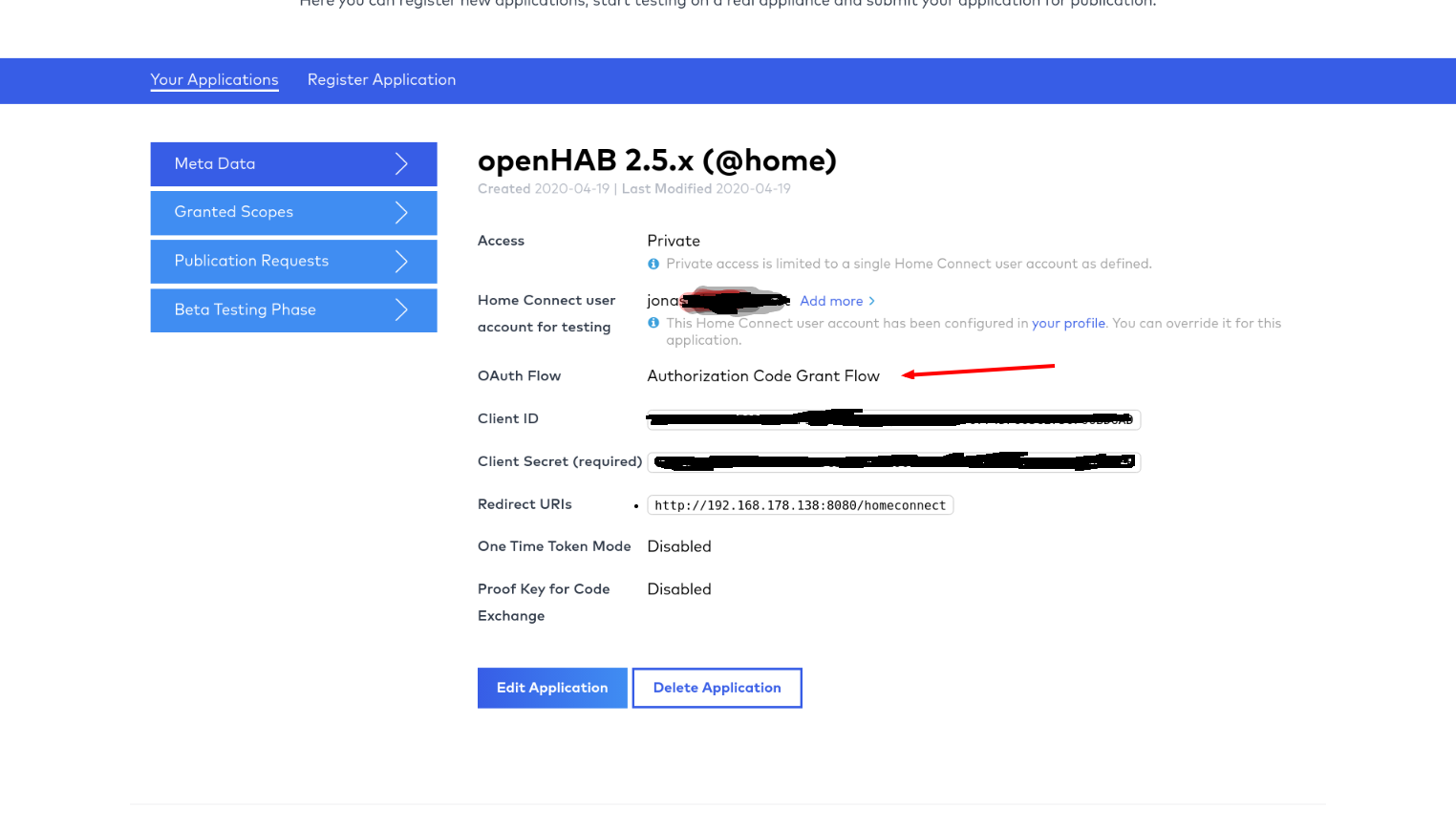

Hi Stephan,
can you please check the OAuth Flow at the Home Connect developer site
Should look like this:

Another thing. Can you please check your settings at the Home Connect developer site. Is One time token disabled?
openhab_2_5_0_authorization_code_grant_flow _ Home Connect Developer Program
I have device flow at this point. I will create a new application with right value. Thanks.

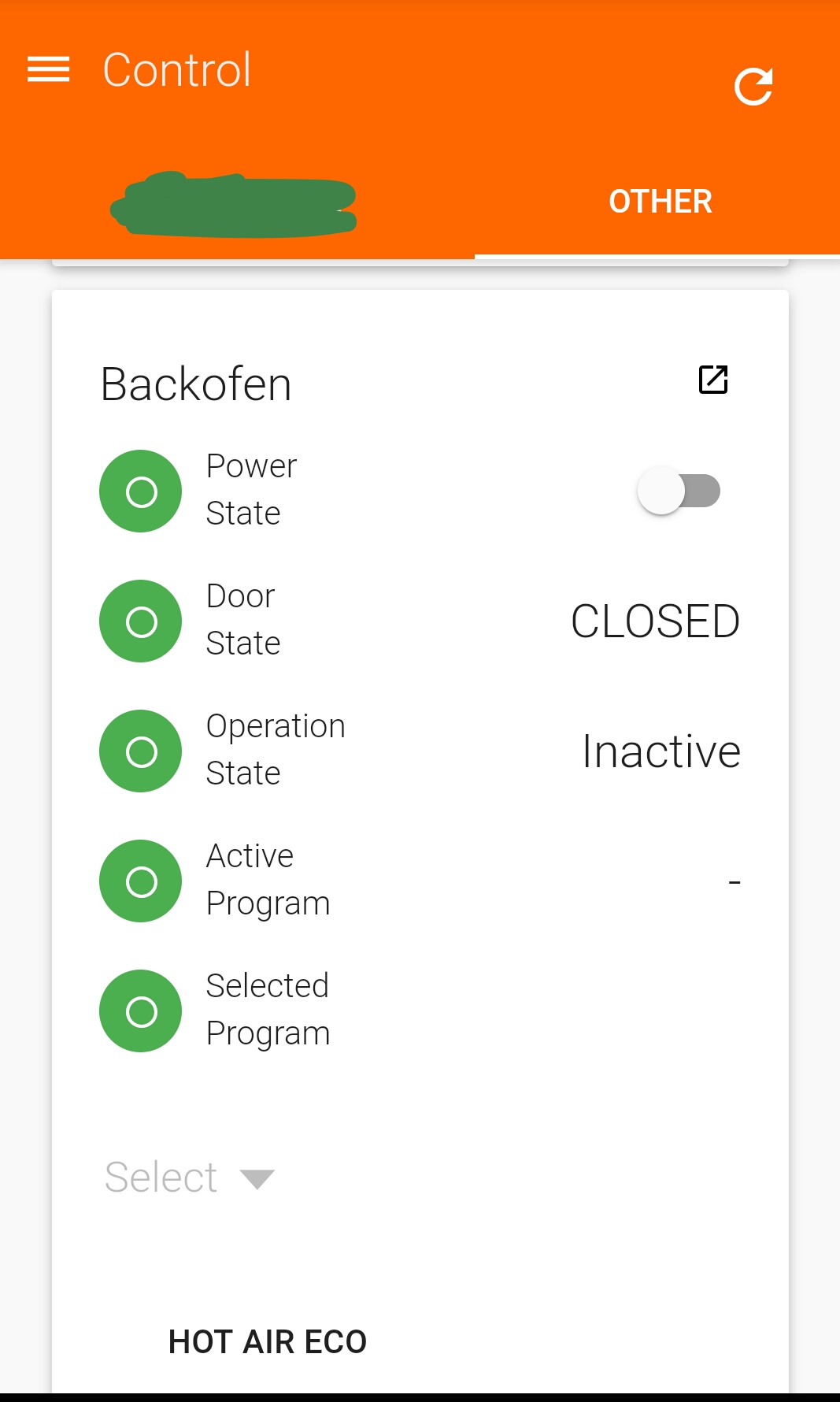

Things are shown as online in openhab as well as the bridge itself. I don’t know how to determime whether my bridge is working fine because I don’t see any Updates on the thing’s channels (e.g. Cook top Power state or oven cavity temp).
