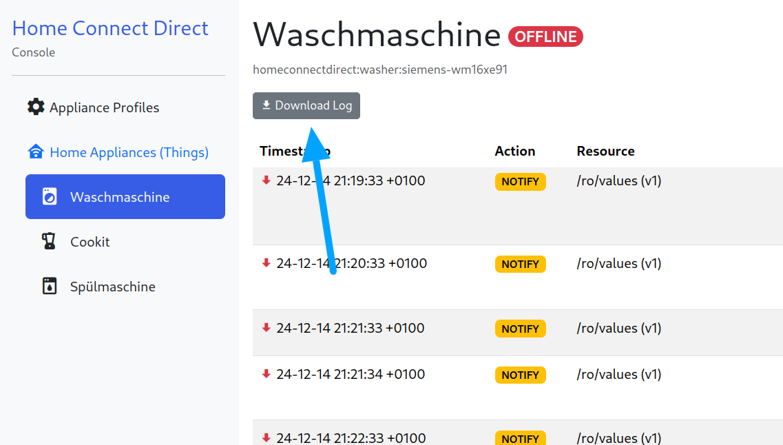

Additionally, the binding comes with a dedicated web UI that allows you to download logs. If you’re comfortable doing so, please send me your logs via private message. These logs will help me support even more Home Connect devices over time.

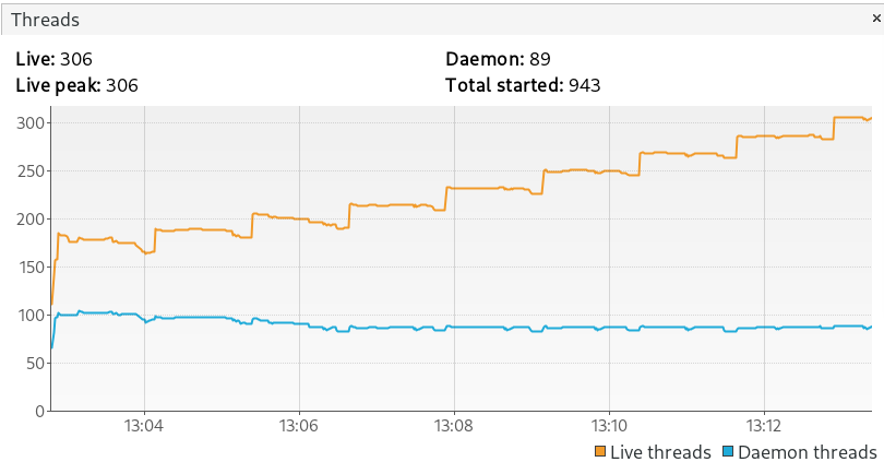

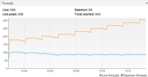

I’m using this binding since yesterday with success. Since today it is running with openhab 4.3. All of my appliances are working well.
But I observed a memory leak since this time.
I’m not 100% sure if this binding is the reason. But the signs point very strongly in the direction.
After a while, the amount of threads in waiting state are increasing a lot. If I check the running threads with “ps -T -p 31”, I get a lot of “HttpClient” threads. If the amount of threads hits the upper system limit, openhab is not able to start new threads anymore and I get a lot of OutOfMemoryError: java.lang.OutOfMemoryError: unable to create native thread: possibly out of memory or process/resource limits reached
Maybe a hint is a different poweroff behavior of my washer. If my dishwasher (SIEMENS) and my coffee machine (SIEMENS) are switched off, they are still reachable via their IP. But if my washer (BOSCH) is switched off, he is not reachable via IP. Seams he is “really” switched off. In the administration webui I can also see the state message “no route to host”.
for now, I temporary uninstalled the binding, just to check if the memory leak is gone.

— update 16.12. 18:52 @jb4711
the thread count is stable since 11am until now (7pm). So it looks like it is this binding.
Thanks for the tip, I’ll have a look at it. For example, if the washing machine is not available, it tries to reconnect to it every minute.

I think this is why my OH instance became unstable / unresponsive after ~24h. After upgrading OH to 4.3 all appliances are offline so for now I uninstalled the binding. :frowning:

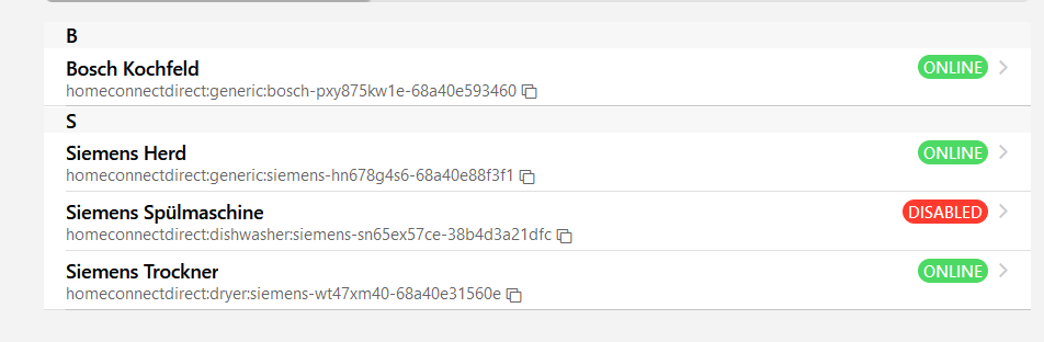

I just installed the new binding. Thank you ver much that you work on this. Everthing look really promissing.
I have a stove, oven, dishwasher and dryer. All are visible:
But I have the follwing issues:
  • Stove and Oven don’t have any channels assigned. Did I do somthing wrong or is it just because they are not supported yet?
  • The dishwasher stay offline/disabled. In the Hommeconnect App the dishwasher is online.

@olialb Strange that your dishwasher is DISABLED. Can you try to enable it via UI. The binding does not actually set this status. Regarding the stove and oven, these only have a few channels. I am trying to expand it. Could you please send me the logs of the devices.

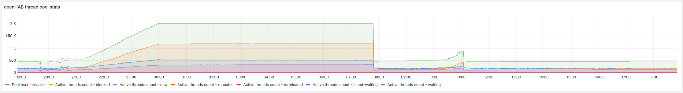

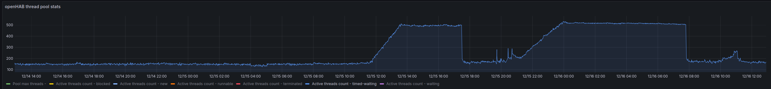

@holger_hees Thank you very much. I had forgotten to destroy the WebSocketClient instead of just stopping it. I was able to recreate the problem and fix it.
Before:
After:
