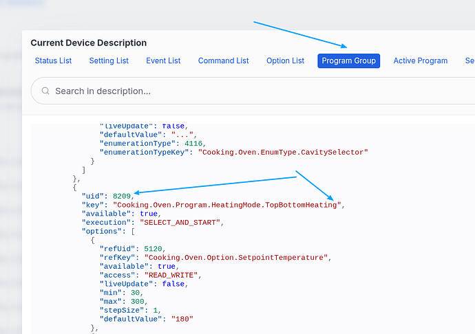

What worked right away on my oven was using the raw-message channel. Here is my payload:
    "action": "POST",
    "resource": "/ro/activeProgram",
    "data": [
            "program": 8209,
            "options": [
                    "uid": 5120,
                    "value": 190
                    "uid": 548,
                    "value": 600
Unfortunately, you’ll have to map the programs manually.

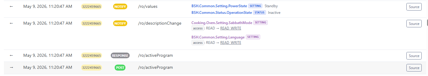

Thanks for the feedback. Mapping is no problem, I already tried this.
I send your payload via raw-message to the oven.
The device makes some sounds (like entering the menu on the touchscreen) and I can see this response in the binding monitor
But the oven is not starting.
Tried capital letter START - no success.
Maybe some kind of protection. Child-lock alike?
For me it starts right away. Even if the oven was in standby mode.
No, child lock isn’t activated.
And as mantioned above, sending this payload with the cloud binding starts the oven immideately:
    json = '{"data":{"key":"Cooking.Oven.Program.HeatingMode.' + program + '"'
    json += ',"options":[{"key":"Cooking.Oven.Option.SetpointTemperature","value":' + temp + ',"unit":"°C"}'
    if (duration !== null)
        json += ',{"key":"BSH.Common.Option.Duration","value":' + duration + ',"unit":"seconds"}'
    json += ']}}'
    Backofen_BasicProgrammAktionen.sendCommand(json)
I just want to switch completly to the direct binding :wink:
By the way: stopwith the direct binding works also, but not the start.
When I send
            "program": 8209,
            "options": [
                    "uid": 5120,
                    "value": 190
                    "uid": 548,
                    "value": 600
directly from the binding to ro/activeProgram, I get this response:
What happens if you turn on the oven before sending the command?
Nothing else…
Can you send me the logs please. It would be great if the logs shows your raw command.
