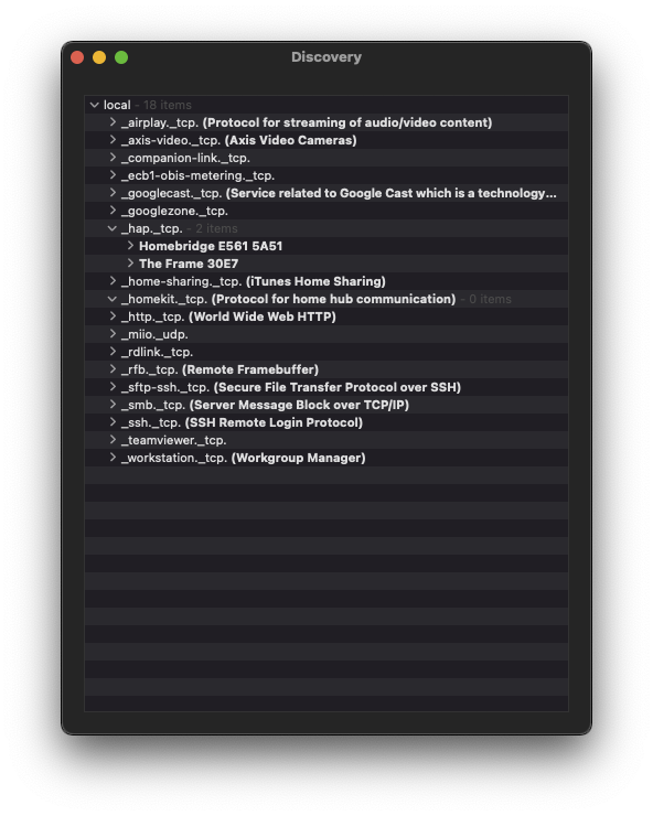

i cannot see homekit there … :frowning:
Guess i will have to dig into docker even deeper …
What a shame net:host is not possible on docker mac.
EDIT: i found this thread:
I also exposed 5353 in the docker config but it did nothing.
i do not even see openhab service in dns viewer …
But i can reach OH via Browser and even send commands to items through the console.

Do i have to add the ip adress the container got assigned from docker into the config maybe?
