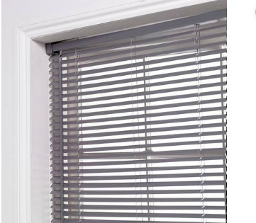

Hmmm, there may be an inconsistency in terminology, perhaps it’s regional. For me:
Rollarblinds
Venetian Blinds
Roman Shades
Personally, I have a large (~1.5 M wide) roman shade that I sewed and built myself that I’d like to automate, hence my interest in this thread. But I’m not certain that my terms are the same as everyone else’s.
