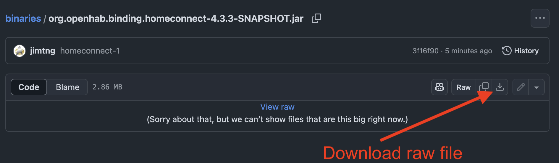

Please test this jar.
It’s only a start (only added 3 lines). So let me know how it goes. I’m totally unfamiliar with homeconnect binding’s code.
Consider opening a github issue too. It’s easier to upload / attach a jar file right in the issue post there.
