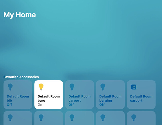

This is my situation before the deliberate error:
(look at the top row)

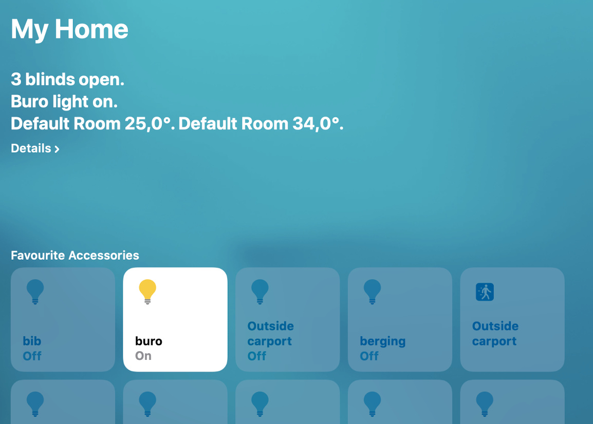

In my .items file, the last line I change to this:
Rollershutter ScreenLivingZuid “Klein raam” (V0_Living, gRollershutters) {channel=“qbus:rollershutter:CTD00XXX:364:rollershutter”, homekit=“WindowCovering”
So I remove the ‘}’ at the end of the line
I get this:

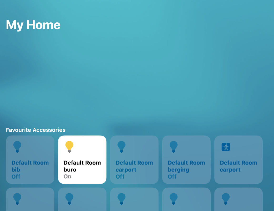

Then I correct the error and get this:
(all on the top line have reverted to the default room again)

ok. this is expected behaviour,
due an error in .items, none of items can be read correctly. basically, openhab reports - no correct items found. (ScreenLivingZuid is probably one of the first items in .items file). homekit binding reports to home app - all accessories are deleted. if home app requests the list of accessories then binding does not know what to reply. it does not keep the list of old accessories and the new one is empty due the error.
not sure how we could prevent this and protect from home app reset.
the only idea i have is to stop homekit binding, do all changes to .items, make sure all items are configured correctly, and then start homekit binding.
