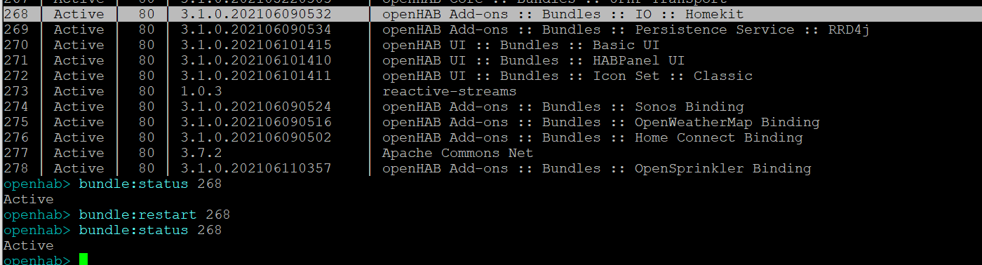

please try 2 following fixes when you lose connection next time.

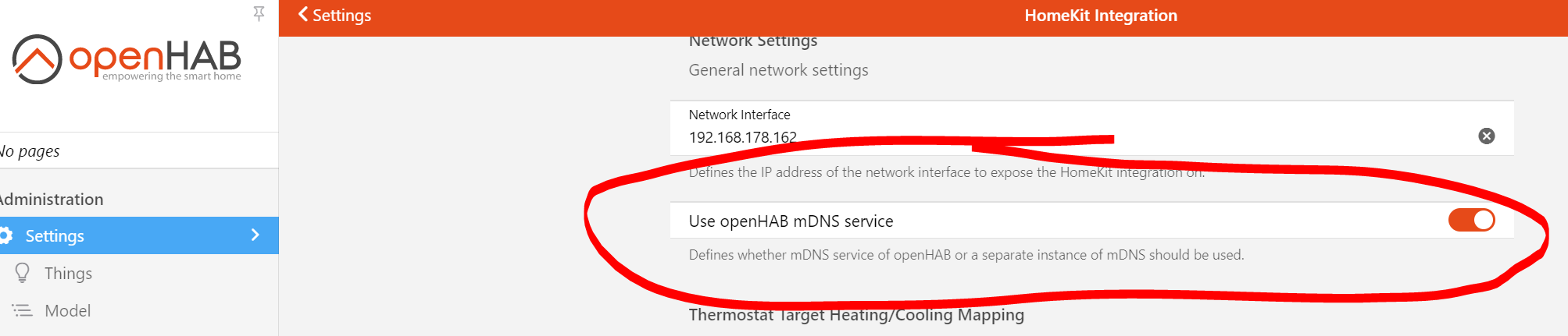

  • in homekit settings in main UI switch on / off the mDNS service
  • restart homekit binding from karaf
removing and adding bridge should the last option

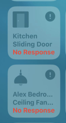

But the main problem is, that all devices (switches, sensors, …) are not responding anymore.

  • switched on “Use openHAB mDNS service” in HomeKit settings.
    (it was turned off by default)
But still all devices (switches, sensors, …) are not responding in the HomeApp :roll_eyes:
hm. that steps usually helped to fix it.
