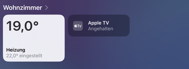

It all works well but I realized, that the decimal places won’t be recognized by Homekit App.
Homekit shows 19,0 ° (comma-separated) while OpenHab App shows 18.8 ° (dot-separated) at the same time. Seems to be rounded from a “float” variable to an “integer” variable.

I think this is more due to the way homekit is working. I can only get a resolution of 0,5 degrees C, despite adding the following in the code:
[minValue=-25, maxValue=50, step=0.1]
Please note the “-25” as minimum value. I have an outside temperature sensor and an inside one. If you don’t add the minValue, homekit will display no temperatures less than 10 degrees C. For inside not a real problem. Outside though…
Thanks, that does help… a little bit. I now get, as you, a resolution to 0.5 degree. Maybe anyone else has an Idea on how to get this do a 0.1 resolution
Reddit shows that this is normal system behavior for Apple Homekit. It’s apparently even like this when fed temperatures directly from Netatmo devices.
