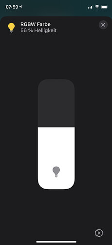

but…with Lightning the bar in Homekit-app turns white!

yes this line works but the app is not showing the color wheel :thinking:

No luck…but its still white bar which is good I guess :grimacing:
hm. it still ignores “Hue” settings.

Interesting…set it to red via openhab app…now:
:rofl:
