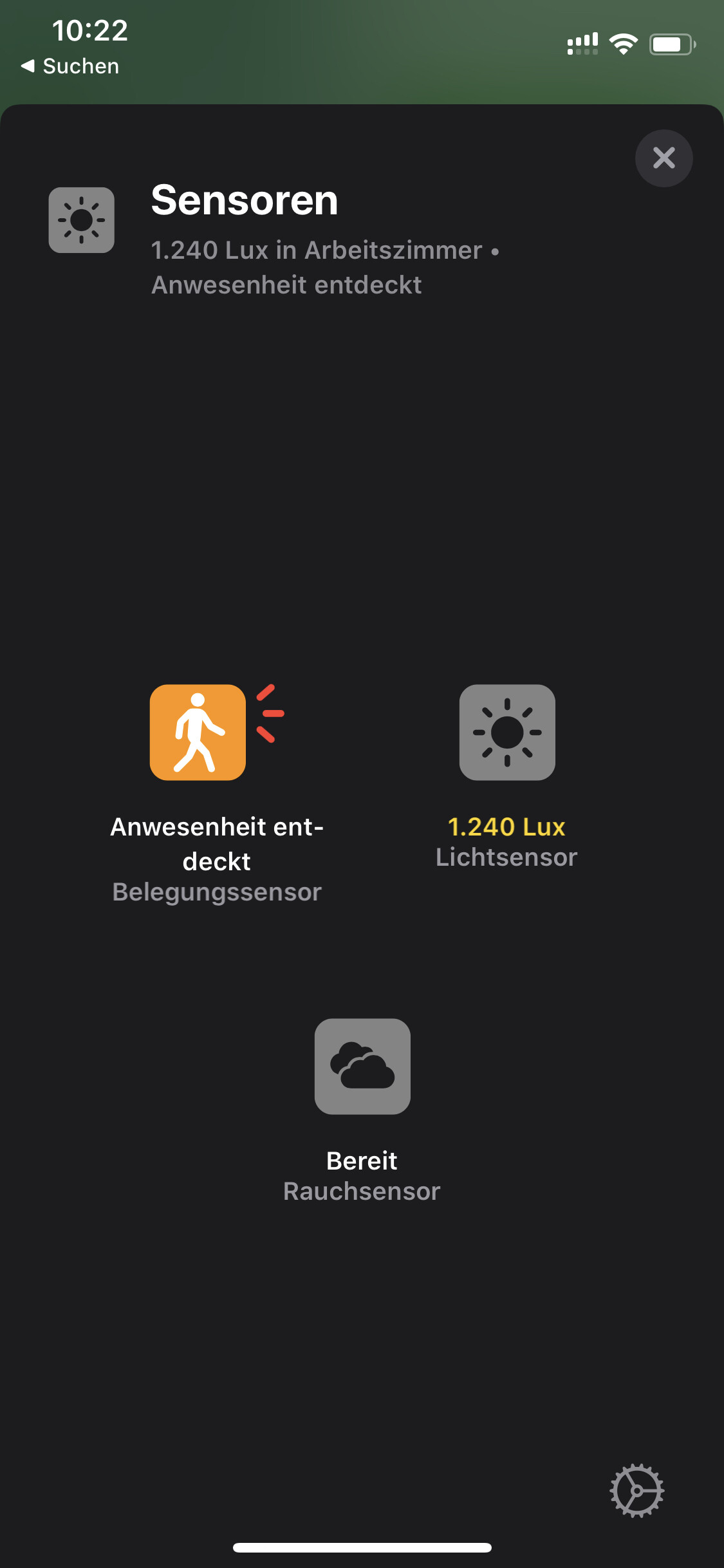

Hi @frankie.delure,
the following works very well for me (inside the accessoies part of the config.json:
    "type": "group",
    "name": "AZ Sensoren",
    "batteryItem": "AZ_B_Praesenzmelder",
    "batteryItemThreshold": "40",
    "items": [
            "type": "lux",
            "name": "AZ Lichtsensor",
            "item": "AZ_S_Licht"
            "type": "occupancy",
            "name": "AZ PrƤsenzmelder",
            "item": "AZ_S_Praesenz"
            "type": "smoke",
            "name": "AZ Rauchmelder",
            "item": "AZ_S_Rauch"
This gives me:
IMG_D1832E9EDB62-1
Not quite sure, where your problem lies.
