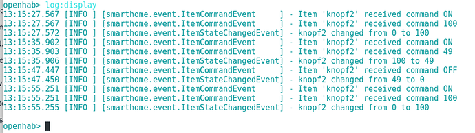

Some log action
Thanks for help!

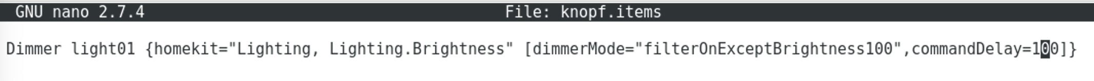

could you please try one more time. increase delay to 100 or so
Dimmer dimmer_light_3 “Dimmer Light 3” {homekit=“Lighting, Lighting.Brightness” [dimmerMode=“filterOnExceptBrightness100”, commandDelay=100]}

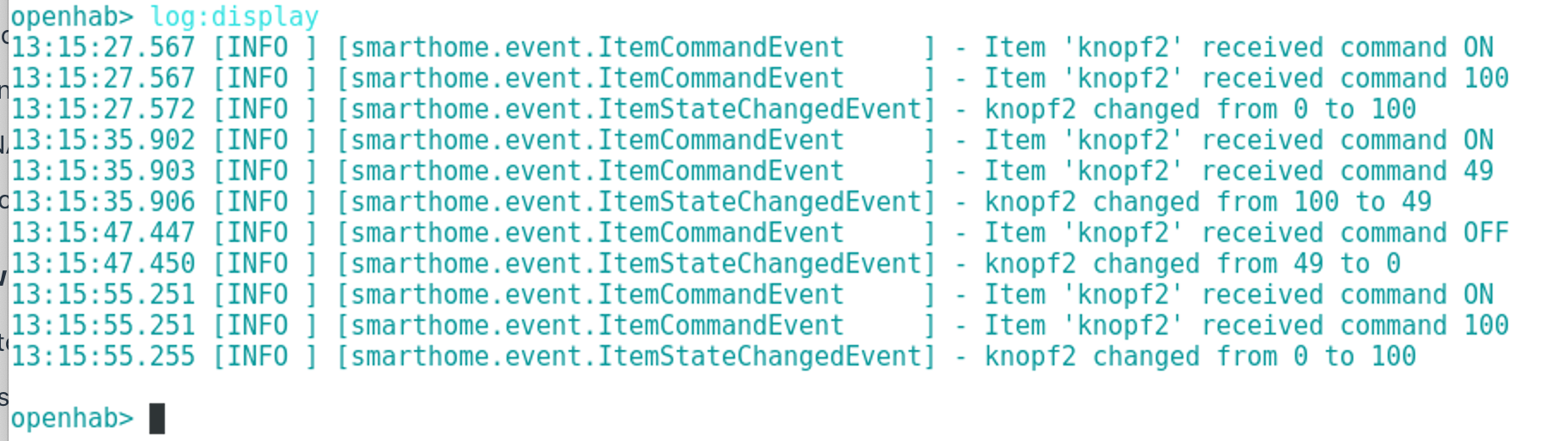

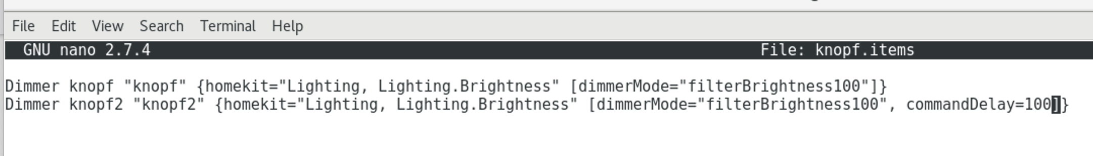

Unfortunately still not working at my side. I tried 100ms and even higher stuff like 1000ms. I also did the same update procedure, didn’t I? Any idea to test?

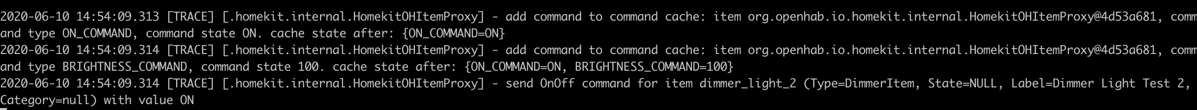

im looking for this sequence. it will tell which commands it has received from home app and which command it has sent to item.
2020-06-10 14:54:09.313 [TRACE] [.homekit.internal.HomekitOHItemProxy] - add command to command cache: item org.openhab.io.homekit.internal.HomekitOHItemProxy@4d53a681, command type ON_COMMAND, command state ON. cache state after: {ON_COMMAND=ON}
2020-06-10 14:54:09.314 [TRACE] [.homekit.internal.HomekitOHItemProxy] - add command to command cache: item org.openhab.io.homekit.internal.HomekitOHItemProxy@4d53a681, command type BRIGHTNESS_COMMAND, command state 100. cache state after: {ON_COMMAND=ON, BRIGHTNESS_COMMAND=100}
2020-06-10 14:54:09.314 [TRACE] [.homekit.internal.HomekitOHItemProxy] - send OnOff command for item dimmer_light_2 (Type=DimmerItem, State=NULL, Label=Dimmer Light Test 2, Category=null) with value ON
thanks for helping me out. here is what I got:
here is the current item:
I miss the “Proxy stuff” in my log.
thank you. but i need log from homekit binding.
it should something with “homekit.internal.HomekitOHItemProxy”..
pls execute this

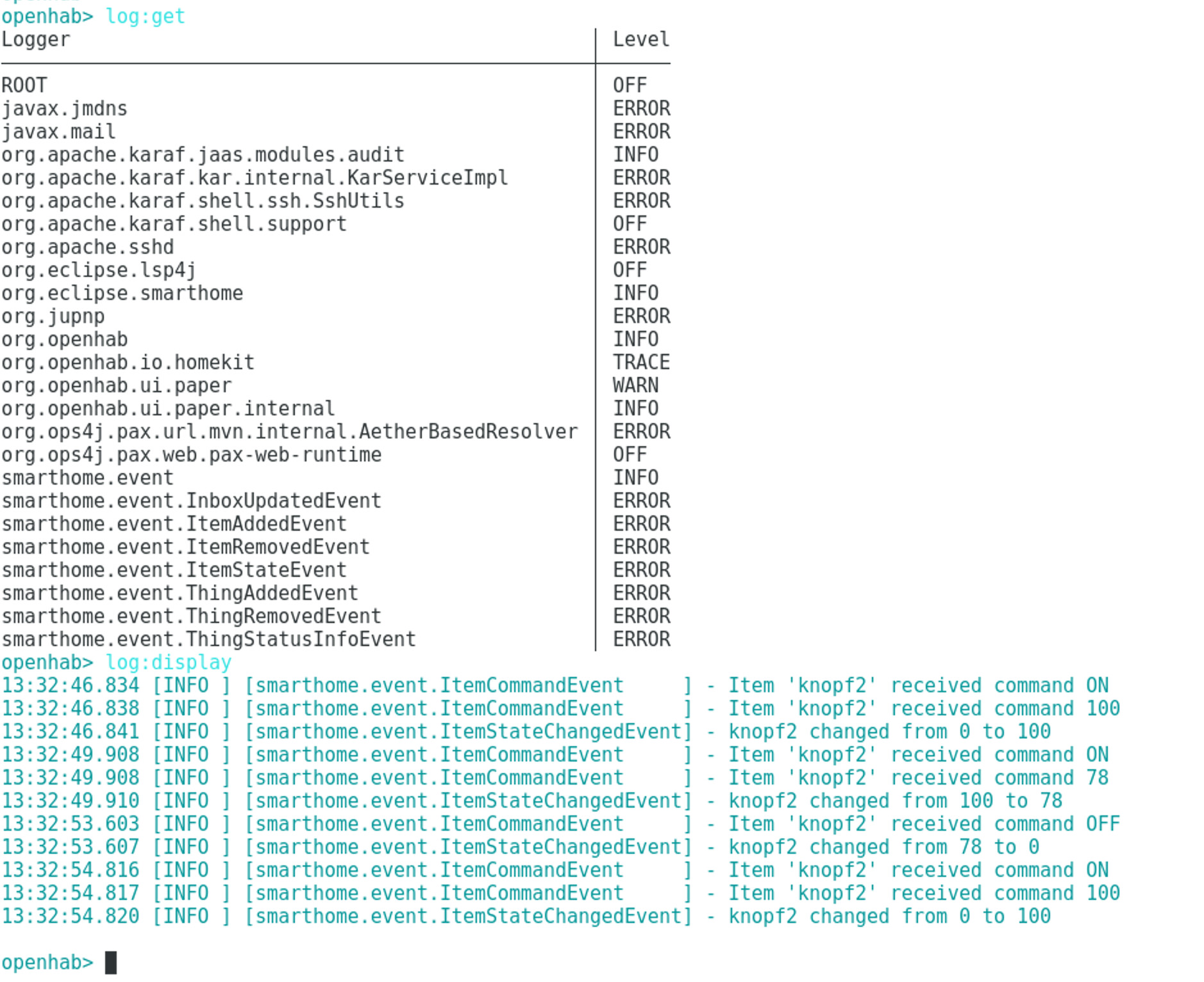

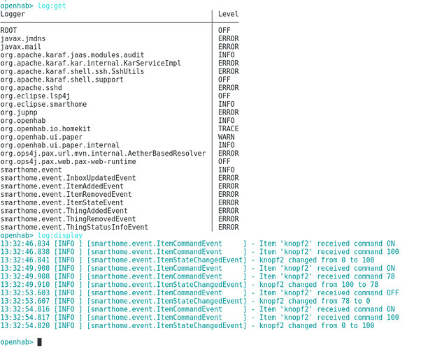

log:set TRACE org.openhab.io.homekit
log:display  | grep OHItemProxy
I guess, I miss something important here. I’m in the console, that’s correct, right? Please see my logging settings.
