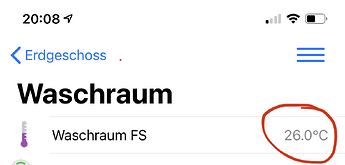

In the iOS homekit app I always get the minimum value for those two zwave items while in the openhab app the zwave items with the same channel shows the correct values. The netatmo items show the correct values also in the homekit app:

The problem is resolved, I just was too impatient. The configuration was right, like I did.
Today morning all values are correct. I think I had to wait until the zwave battery (!) devices passed a wakup cycle.
It seems, that the homkit addon does not get the existing values from zwave devices, but only receives them when they where updated…
