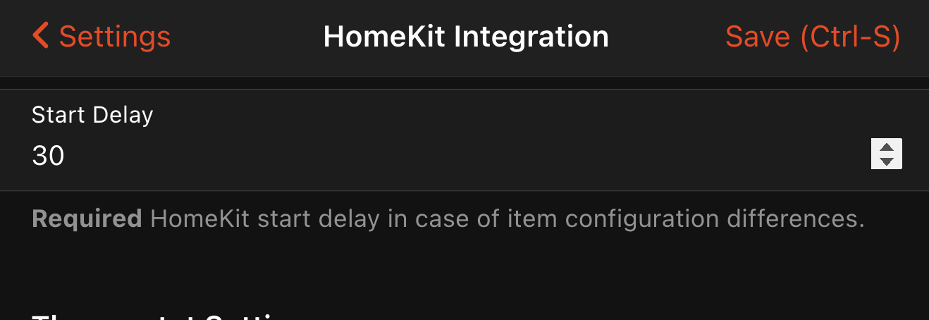

nevertheless, try to increase startDelay via ui settings

I will try to increase the startDelay though, which I didn’t know of.

I have increased the startDelay from 30 to 120 (I’m assuming these are seconds) and restarted openHAB. This time the devices remained assigned to their rooms. I will monitor the situation and do a couple of more restarts tomorrow.

Just in case you are still looking (and for everybody else): You have to look under “Other Services” and not under “Addons” → Bindings. I’m running openHAB 3.1 Release.
