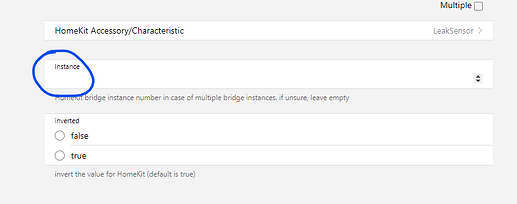

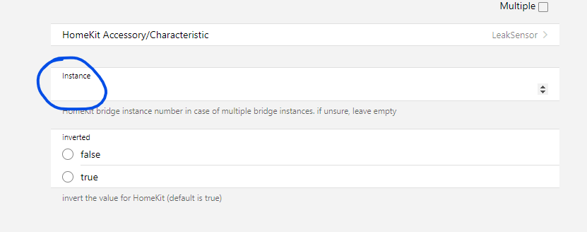

It`s my mistake. I have some Openhab installations and forgot that multibridge can be possible from 3.4 version. At 3.4 version I can easy to setup number of Bridge from UI:
For rather big Object it is very usefull to cut Openhab`s (or other Systems) objects to some Bridges. Sometime I got situation, when a rather litlle changes in System can reset my setups in Homekit. For example reset all renames of objects, sortings, rooms and other things. There is better correcting some part of instalation than full of it.
