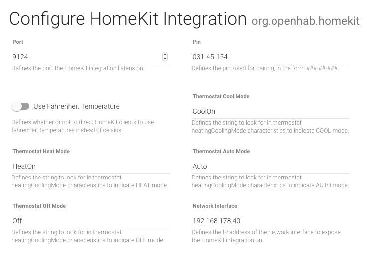

my Homekit OH2 Configuration

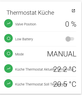

In Paper UI my Items are shown:
