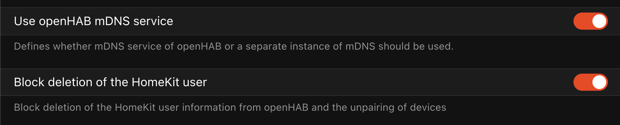

we have added a switch to homekit settings that disables deletion of the user from homekit.json by binding.
not sure whether it solves 100% of all issues related to missing user in homekit.json but at least the user will not be deleted by binding.
available in openhab 3.2 and is “off”/“not active” by default
Thanks! I just turned the switch on. I’ll keep you posted.

Just wanted to let you know that I haven’t had any issues since I turned the “Block deletion of HomeKit user” switch last week. Thanks again.
p.s. Running 3.2.0 Stable release.
Unfortunately in my case enabling this switch did not help. It took only a day for all items to lose room assignments. However - interestingly - this time they didn’t end up in the “standard room” like before but in the room where openHAB was located.
The day before yesterday I updated to 3.3.0.M1 and disabled the “Block deletion of HomeKit user” switch. No issues so far – although it is a bit early to tell.
It looks like I jinxed it. Today HomeKit security stopped working. I didn’t want to completely start over, so I tried to remove just security by removing the HomeKit metadata for it. No luck. It’s a zombie that won’t go away. I also tried disabling the “Block deletion of HomeKit user” switch without any luck. I put it back on and everything else seems to still be working for now.

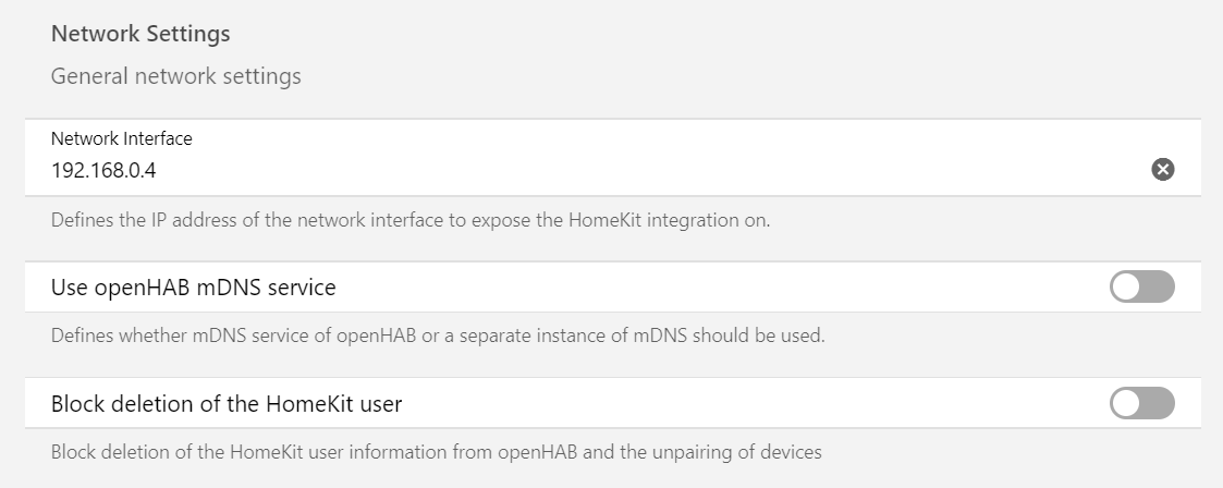

I had the same problem. After a reboot I had to toggle the mDNS switch.
The solution:
Enable port 5353 (mdns) and 9123 (homekit) for IPv6 (in the firewall)
Now I can restart openhab without changing the mDNS switch.
Perhaps the mDNS switching causes the change in the response between IPv4 and IPv6.
this could well be.
this logic is like this
  • if IP address is defined in homekit settings and there is network interface with this IP address, then use it for homekit comunication
  • else take any IP address of any existing network interfaces. so, if you change the switch and you have not IP defined in the homekit configuration, then it IP used for homekit could change.
I defined a IPv4 like this.
This IPv4 takes first affect after switching mDNS on/off.
After enabling Ipv6 it is working without toggeling the mDNS swich.
