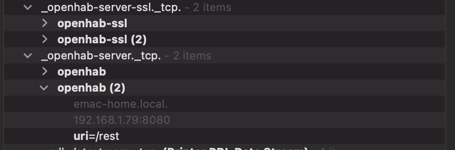

I can see now 3 entries for both _openhab-server-ssl and _openhab.server - this morning I had 2 entries only for each.
it looks like docker creates suddenly one additional ipv6 address, openhab make us of this additional address, means it can be reached under this new address. but homekit can use only one address and get confused by the new address.
i would recommend:
  • set ipv4 address in the homekit settings
  • deactive ipv6 support either on docker level or via this java parameter
    -Djava.net.preferIPv4Stack=true
