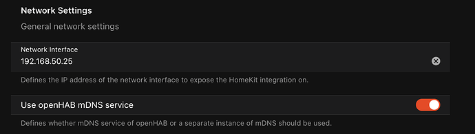

Lets start with a fresh start of my openhab container. My HomeKit Configuration looks like this:

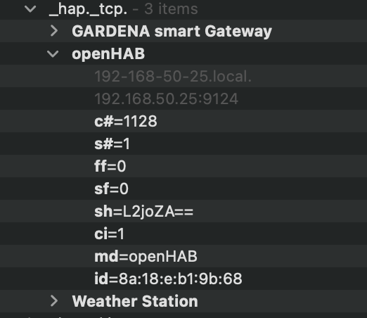

My mDNS Browser looks like this after everything is started fresh in _hap._tcp.

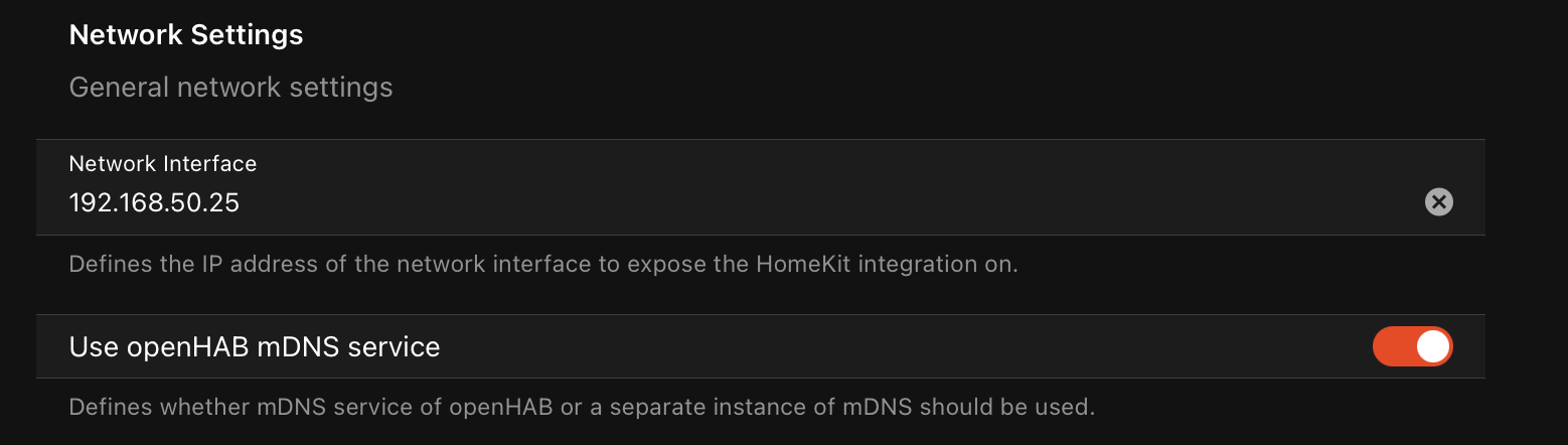

Next step is to activate Use openHAB mDNS service and saving it:
And now, in mDNS Browser there is a new entry and HomeKit gets a Connection to openhab.

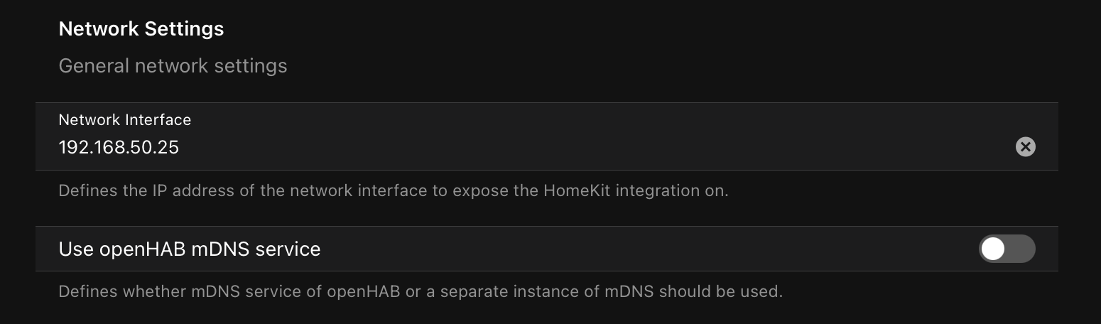

But with that option enabled, it works only for 24h. So that’s why I have to disable the option again:

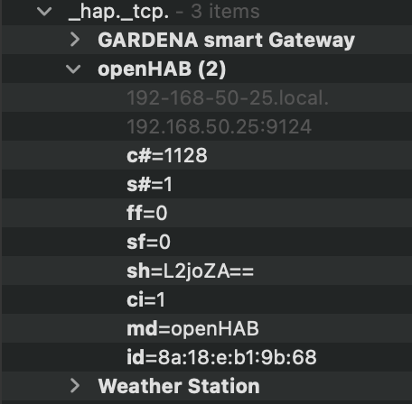

and then mDNS Browser shows this:
and then everything works fine until the next restart of the container or with openhab cli with bundle:restart "HomeKit ID"
So seems, that with the disabled option there is no mDNS Service started at openhab start. Hope my explanation will help out a bit.

what is especially interesting is the label “openHAB (2)” on the screenshot number 4. (2) is added automatically by mDNS if there is already a service with the name openHAB. but in you case, it is the only one.
