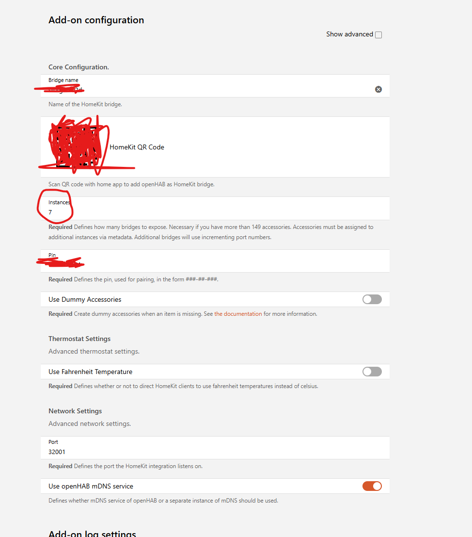

May I ask how you added anothe instance? Maybe I am blind… how to do that? :innocent:
Then you specify the instance number when you set the metadata for each item
