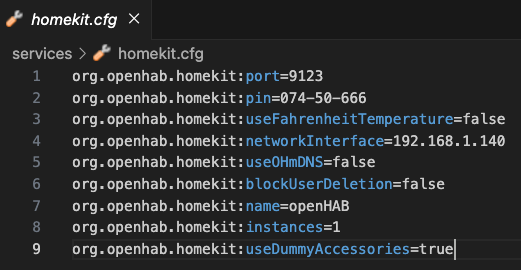

Hy Homekit is declared by text file :
the config is not correct.
{homekit = “type of device” …}, e.g. {homekit=“Switchable” …} or {homekit=" Lighting" …}
means, replace
with
Switch                Presa_75                 "Presa 75 - Luci Laboratorio"                      <light>               (GR_Laboratorio, MH_Prese)                              ["Switch"]            {homekit="Switchable", channel="openwebnet:bus_on_off_switch:BT_MH202:T_Presa_75:switch"}
btw, [“Switch”] is not required.
see HomeKit Add-on - System Integrations | openHAB for more examples
Hi, thank you very much for your support,
and sorry for the time I made you waste…
In fact, I didn’t clearly understand what metadata could be inserted for Homekit,
I had understood it to be the name of my item,
while in reality the table clearly specifies the values that can be inserted.
SORRY !!!
Now everything works great!!
I can add and remove items,
and after a few seconds I find the changes immediately reflected in my HOME app.
THANK YOU !! :star_struck: :star_struck: :star_struck: :star_struck:
Greetings
no problem. you are welcome!
happy to hear that it is working now.
