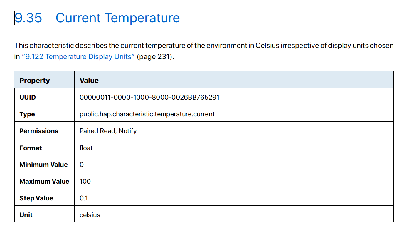

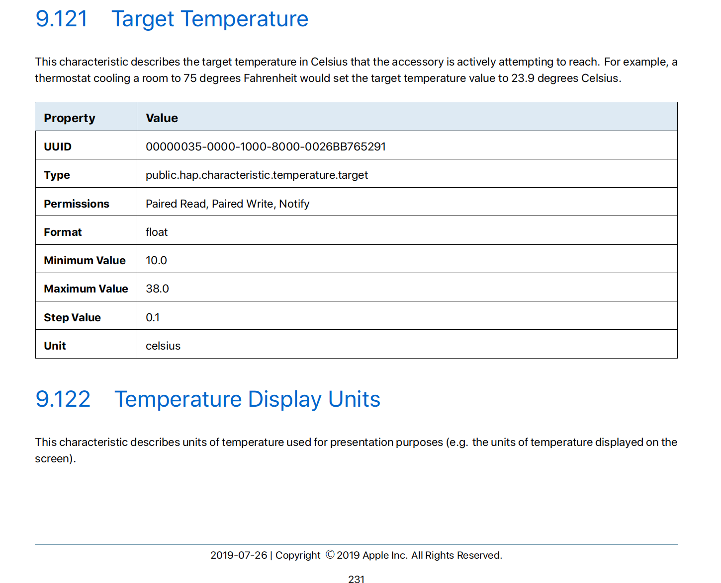

HomeKit internally works only with C (see screenshot below),
means OpenHAB would convert F->C and sends C to HomeKit, home app would then convert C->F for displaying purposes.
the minValue and maxValue are also in C.
can you try to remove min/maxValue?

@yfre Well that was it. I changed the min/max values to Celsius and its working… Thanks
Number:Temperature BalboaIPUnit_CurrentTemperature "Current Temperature" <temperature> (BalboaIPUnit) ["Temperature"] {channel="balboa:balboa-ip:cb364e02de:current-temperature",homekit="Thermostat.CurrentTemperature"  [minValue=26.7, maxValue=40.0]}
Number:Temperature BalboaIPUnit_TargetTemperature  "Target Temperature"  <temperature> (BalboaIPUnit) ["Temperature"] {channel="balboa:balboa-ip:cb364e02de:target-temperature",homekit="Thermostat.TargetTemperature" [minValue=26.7, maxValue=40.0]}
