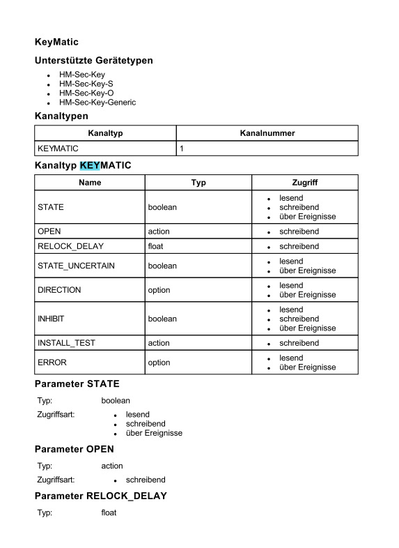

But using homematic binding with OH i can only unlock the door. According to wiki binding and provided link to DataPoints for CCU2 there is no datapoint to lock the door :slight_smile: i checked CLOSE (as OPEN works for unlocking) but log file says :
Can't find DatapointConfig[address=LEQ090xxxx,channel=1,parameter=CLOSE]

Thank you for explanation. Using STATE datapoint i can now lock and unlock the door so most important functionality has been achieved :slight_smile:

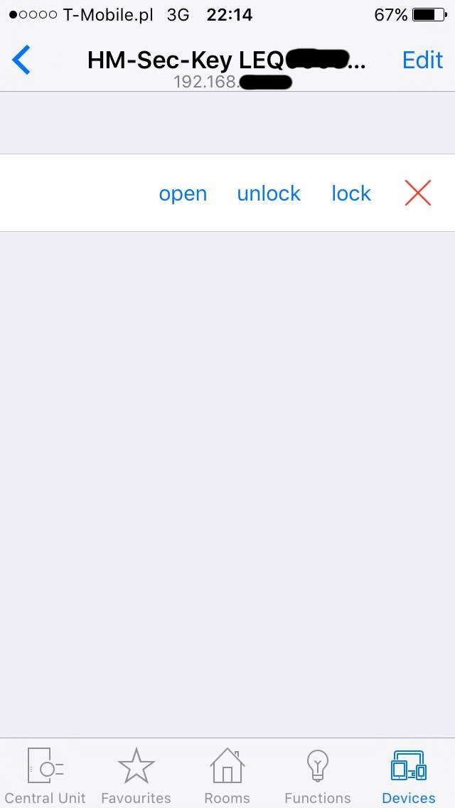

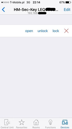

Last question: using webui on CCU2 or phone app there is 3rd option useful for me (apart from lock and unlock) to open the door - is it posible to have this functionality in OH using homematic binding?

What about opening the doors? There is such a posibility and iths working with keymatic using CCU2 webpanel or @Home ios app. Which datapoint is responsible for this functionality ? I would like to use it in OH.
Lock and Unlock is using the State boolean and Open (like you can walk through) is triggered by the Switch KeyMatic_Open
{homematic=“address=MEQXXXX, channel=1, parameter=OPEN, forceUpdate=true”, autoupdate=“false”}
