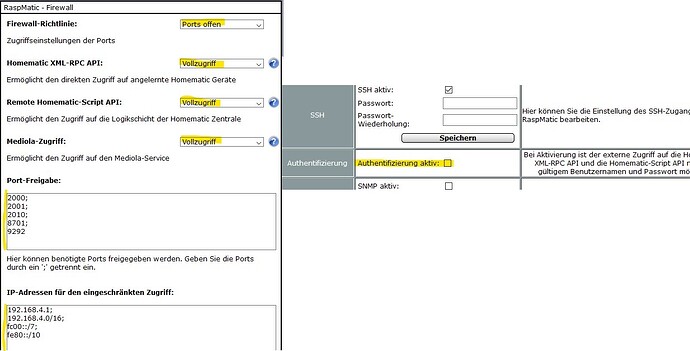

  • Raspberrymatic / CCU Firewall + Auth configuration:
    The ports shouldn’t be required as access is anyway set to “Full” above.

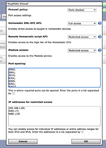

my OH has the IP 192.168.1.80
raspberrymatic: 192.168.1.46
here are my setting in raspberrymatic
i have few more ports offen but im not sure whether all needed (probably not).
but maybe you could try to add these ports to your setup
2000;
2001;
2010;
8701;
9200;
9201;
9202;
9127;
9292

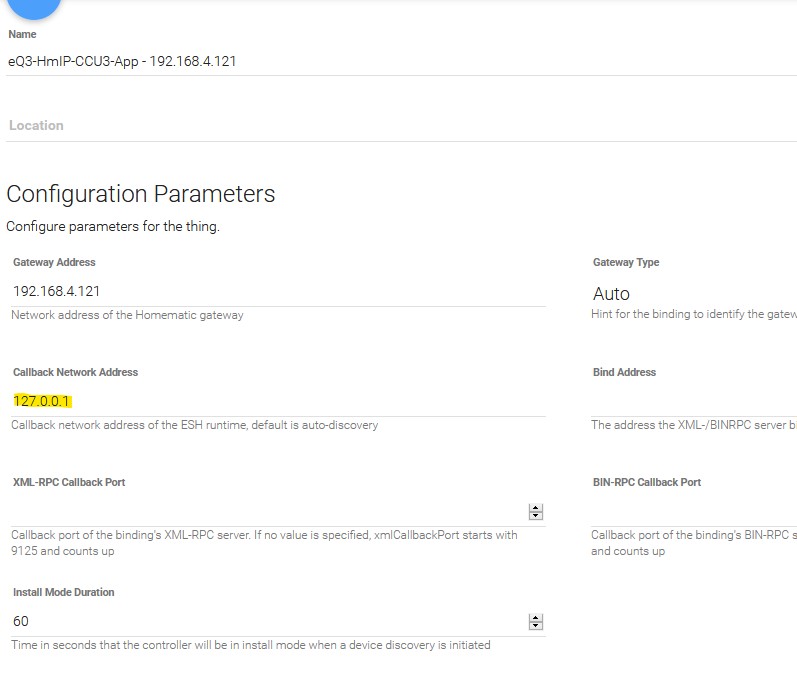

Now that I know the root cause and read through your answers again, @yfre gave the better solution:
OH things configuration of CCU, set in PaperUI or in things file
callbackHost = 127.0.0.1
(you might have to disable the thing and re-enable to get it Online properly. Watching the DEBUG logging helps)
