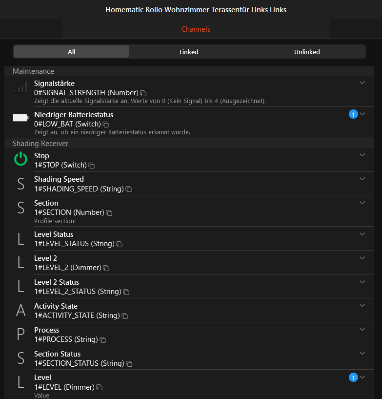

My Things and Items are created via text files. My homematic.things for this curtains looks like this …
Thing HmIP-HDM1 0000448151004F "Homematic Rollo Wohnzimmer Terassentür Links Links" {
Channels:
Type HmIP-HDM1_1_LEVEL : 1#LEVEL [
delay = 3,
receiveDelay = 22
The Thing does not even have #LEVEL_2 as an item…
I have already tried everything. Deleted the Thing and Item file and reinitialized. I created the Thing and Item via WebUI but everything was without success until now.
I also have the feeling that my openhab significantly reduced performance due to the error. Does anyone have an idea how I could get rid of the error?
