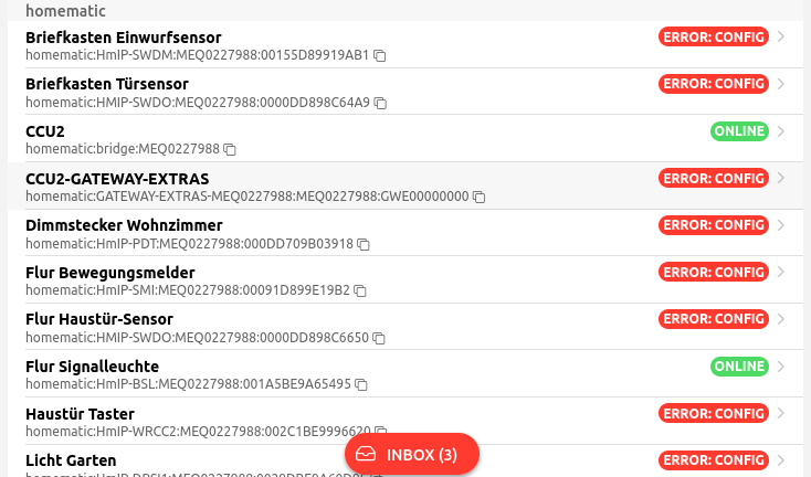

I have the same problem since last week. Increasing the discover time helped me at first.
Now some devices are missing on every restart of openHAB!

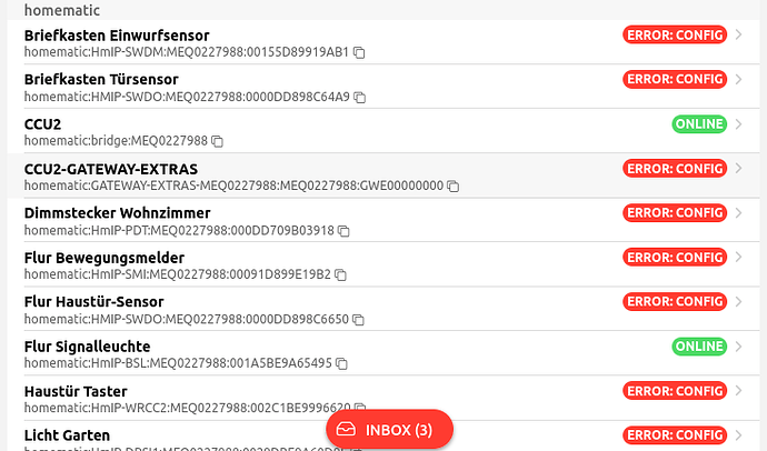

I’m having a similar issue, not sure for how long, but I remember not having had this when I started with OH 3.1.0: After rebooting OH, not all things manage to get online with the Device with address 'xxx' not found on gateway 'yyy' error message
2022-03-17 20:16:38.328 [INFO ] [ab.event.ThingStatusInfoChangedEvent] - Thing 'homematic:HMIP-SWDO:MEQ0227988:0000DD898C64A9' changed from INITIALIZING to ONLINE
2022-03-17 20:16:38.457 [INFO ] [openhab.event.ItemStateChangedEvent ] - Item 'Thermostat_Garten_Humidity' changed from 69 to 69 %
2022-03-17 20:16:39.881 [INFO ] [ab.event.ThingStatusInfoChangedEvent] - Thing 'homematic:HmIP-SMI:MEQ0227988:00091D899E19B2' changed from INITIALIZING to ONLINE
2022-03-17 20:16:40.039 [INFO ] [openhab.event.ItemStateChangedEvent ] - Item 'Rolladen_Kueche_Rechts_Stop' changed from OFF to NULL
2022-03-17 20:16:41.408 [INFO ] [ab.event.ThingStatusInfoChangedEvent] - Thing 'homematic:HmIP-BSL:MEQ0227988:001A5BE9A65495' changed from INITIALIZING to ONLINE
2022-03-17 20:16:42.884 [INFO ] [ab.event.ThingStatusInfoChangedEvent] - Thing 'homematic:HmIP-BROLL:MEQ0227988:00111A49A8DEF0' changed from INITIALIZING to OFFLINE (CONFIGURATION_ERROR): Device with address '00111A49A8DEF0' not found on gateway 'MEQ0227988'
2022-03-17 20:16:42.888 [INFO ] [ab.event.ThingStatusInfoChangedEvent] - Thing 'homematic:HmIP-BROLL:MEQ0227988:00111A49A8DDCC' changed from INITIALIZING to OFFLINE (CONFIGURATION_ERROR): Device with address '00111A49A8DDCC' not found on gateway 'MEQ0227988'
2022-03-17 20:16:42.891 [INFO ] [ab.event.ThingStatusInfoChangedEvent] - Thing 'homematic:HmIP-BROLL:MEQ0227988:00111A49A8DDD0' changed from INITIALIZING to OFFLINE (CONFIGURATION_ERROR): Device with address '00111A49A8DDD0' not found on gateway 'MEQ0227988'
This is especially odd because most devices manage to get online.
Does anyone have an idea?

I had the same issue, after the upgrade to the latest milestone. As nothing big was mentioned in the patchnotes regarding homematic, I assumed the problem is on my end.
I tried restarting both, first CCU3 then OpenHAB, which didn’t fix the issue.
I then changed the buffersize from 2048 to 4096 and this worked for me. I assumed this is due to the number of Homematic Items I have in my setup.

Your hint (increasing the buffer size from 2048 kb to 4096) unfortunately did not change the picture for me.
Some observations:
  • Still, independent from the buffer size-setting, a partially large share (> 50% of all homematic devices) does not manage to go online. This also seems pretty reproducibly.
  • When I was at openHAB 3.2, the number of homematic devices that did not manage to go online was either much lower, or 0, so at least for me it seems as if something has changed with openHAB 3.3. Needless to say that this is now a pretty big issue.
  • Sometimes, some time after the reboot, some (but not all) of the homematic devices still manage to go online: 22:55:04.045 [INFO ] [hab.event.ThingStatusInfoChangedEvent] - Thing 'homematic:HmIP-PDT:MEQ0227988:000DD709B03918' changed from OFFLINE (CONFIGURATION_ERROR): Device with address '000DD709B03918' not found on gateway 'MEQ0227988' to ONLINE. So the information “not found on gateway” is clearly misleading, as it seems more like a connection problem.

And good news first: After having performed 20+ restarts, I managed to reproduce the problem at least a bit, though did not manage to solve it.
You’re right, I kept having the same problems also in previous versions. Now that I think about it, the more homematic devices I kept adding, the more persistent the problem became.
So here’s what I found out (funny coincidence: I mixed up the parameters “Timeout” with “Callback Reg. Timeout” at first, so I did some tests with both):
  • Increasing the “Callback Reg. Timeout” even up to 600 (to be absolutely sure) does not solve the problem.
  • Increasing the “Timeout” (also even up to 600, also to be absolutely sure) also does not solve the problem.
Here’s something funny, which makes me think that the problem is timeout-related, but maybe not related to the two parameters I kept testing:
  • While the problem of some homematic things remaining in “offline” always persists if I either reboot the Raspi or just the openHAB container
  • … the problem never persists if I just disable the CCU2-thing in openHAB and enable it again, to trigger openHAB to re-initialize all homematic things.
I suspect that the problem only occurs with HmIP devices. The cause of the problems is the behaviour of the HmIP service in the CCU and some devices. After a restart of the CCU it takes some time until the HmIP service is ready (for this the Callback Reg. Timeout setting).
But depending on the device it can take about 5 min. until the device is fully available in the CCU itself. This meand that they will be shown as offline in OH. If later one of these devices sends an event (like a changed temperature) its state should change to online.
So, after a restart of the CCU you should wait some minutes (about 5) until you restart OH or disable and enable the CCU2 thing.
I have some ideas to solve this problem in OH but this would mean a reimplementation of the connect handling and possibly some breaking changes.
I could spend some time today, trying to figure out how to reproduce the various things I observed. From what I can see, fixing this maybe isn’t that complicated after all?
Here are my reproducible findings:
  1. Rebooting the entire raspi: ~50% of all my HmIP-devices always remain offline.
  2. Restarting just the openHAB container: ~50% of all my HmIP-devices always remain offline.
  3. Doing the above with / without rebooting the CCU shortly before: No impact at all!
  4. Playing around with the CCU parameters “Callback req. timeout” or “Timeout” in openHAB: No impact at all!
  5. Disabling the CCU-thing and enabling it again: Always solves the problem and results in all HmIP-devices coming online.
