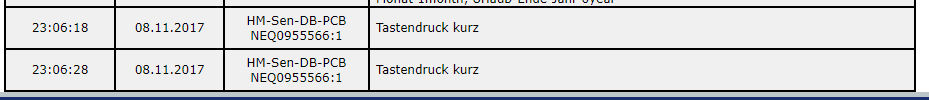

Currently my doorbell sensor is paired with homematic, and in my homematic “eventlog” i can see, that the ring events are noticed correct:
