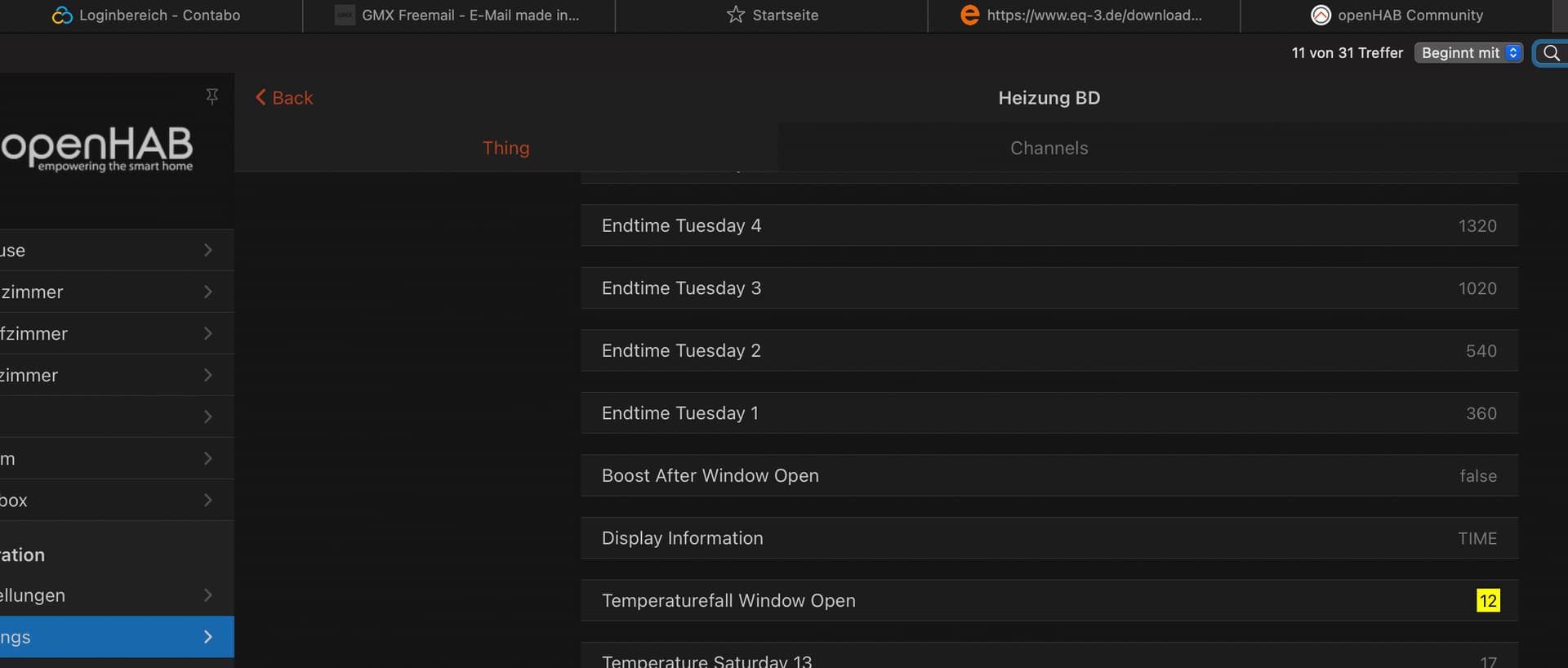

i like to change a special configuration (Temperaturefall Window Open) of my HM-CC-RT-DN via openhab3 and homegear. Unfortunately this config is not part in the local device menu.
I’m able to see the value of “Temperaturefall Window Open” if i open the thing in the Web. I like to change the “12” to another value. But it’s read only :confused:
Any ideas ?
Thx, Hagi

You can see the answer to your question in your first screenshot:
If you want to change the value(s) in Main UI, you also have to create the things in Main UI.
