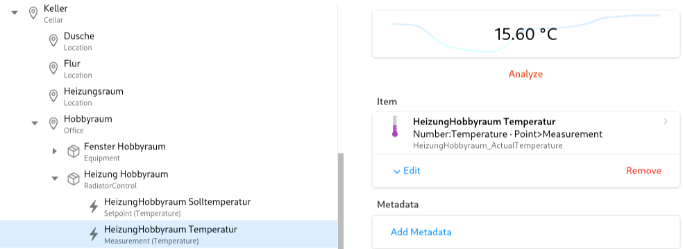

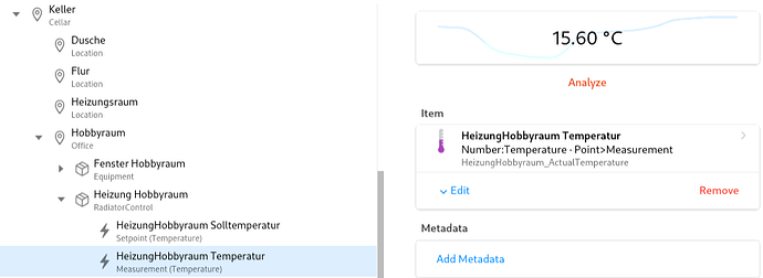

I already added some of those to OpenHAB 3 via the semantic model (if you can say so) and can see their status. I didn’t try to control one of those devices yet, but will probably today or tomorrow and let you know if this works.

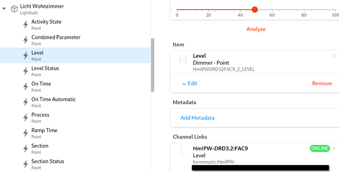

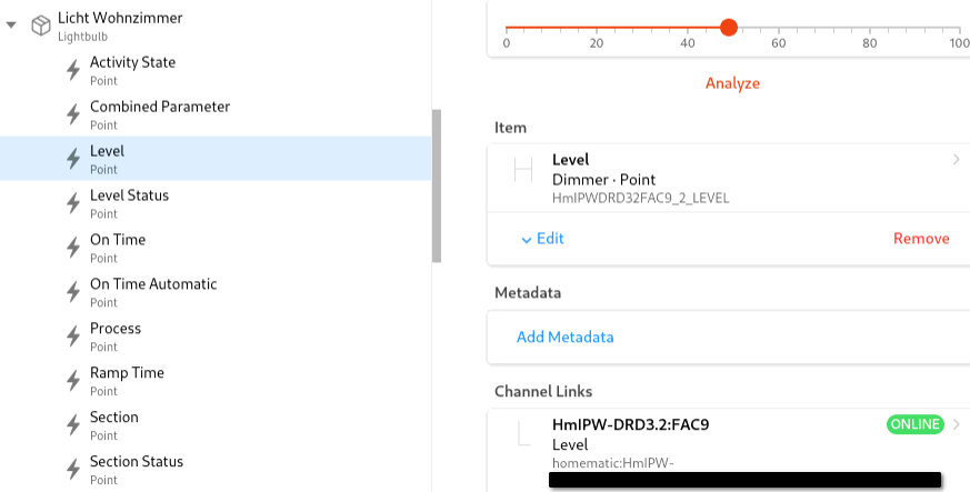

I was able to set the dimming level on a homematic IP wired dimming actor:
However, I’m not really sure if I use the right channels and whatever as I’m totally new to OpenHAB.

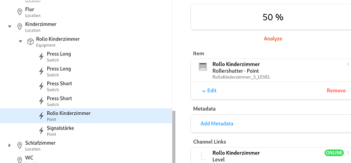

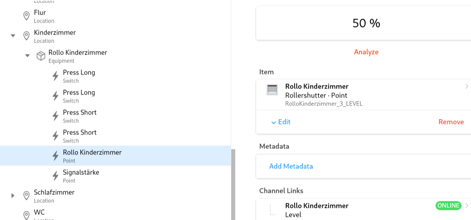

Autodiscovery is working here too for hmip wireless and wired devices [latest RaspberryMatic] @Piffer do you have wired actors for rollershutters? - take definitly care of the right channels, you can damage the controls from raspmatic side…so they probably won’t work when writing to the wrong channel. Will try to include them tomorrow by copy pasting item files from my running oh2.5 instance and report.
From another post which I can´t find at the moment, probably not here in the community… The number in the channel name before the # maps to the channels in the Homematic UI. Make sure to use the right channels 1+2, 5+6, 9+10, 13+14. The control via for example Channel 3# works too for the rollershutter on channel 2# but it sets some value you cant see in the Homematic UI and the rollershutter can’t controlled correctly any more directly via Homematic UI.
