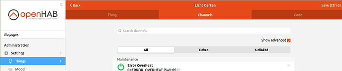

Not sure if this is still relevant, but if the checkbox “Show advanced” is activated…
… it shows the entire list of channels, which also contains the ones mentioned above (e.g. unreach, update pending, etc)
