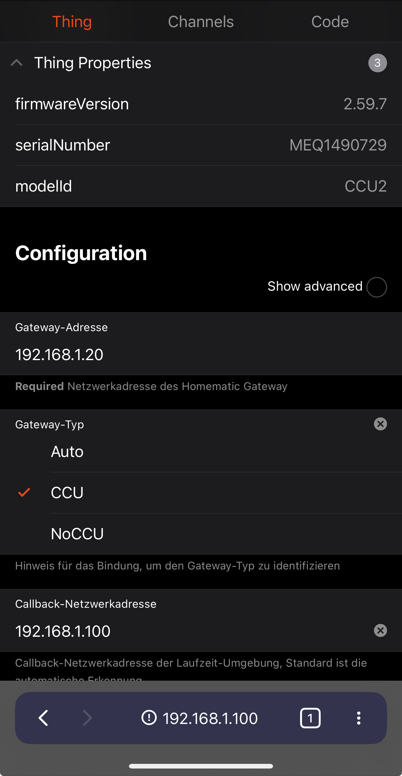

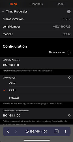

That’s a good question. Please check the Homematic binding. There should be a parameter Callback network address. What’s the value of this parameter?
It’s empty. The ‘Gateway-Adress’ of the CCU2 Thing is set to the CCU2 address: 192.168.1.20
Btw: I have no idea how to ‘open a shell on the CCU to ping openHAB’. Can you help me out?
Edit: what I don’t get: why are all Homematic things (incl. CCU2) online in openHAB?
I’m not talking about the gateway adress. I’m talking about the callback adress. It must be the address of the Openhab Server.
About your question: All thinks are online because while the binding is starting, all item of the CCU are queried. That’s way all thinks goes online. In addition while the binding is starting, the binding sends the callback adress to the ccu. The CCU uses this adress to reports all changes in any device to openhab.
I think I tried the same setup yesterday but it didn’t change anything. I’ll do a restart and see what happens. :slight_smile:
Yes. Please have a try.
@mr.airworthy And does it work?
Good morning. Just checked the status this morning. Everything is running again.
@Christian_Kittel thank you so much!!! You’re the man!
For whatever reason both openHAB and CCU2 needed a restart to finally communicate again.
