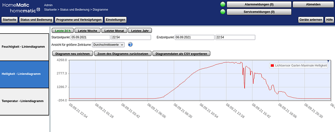

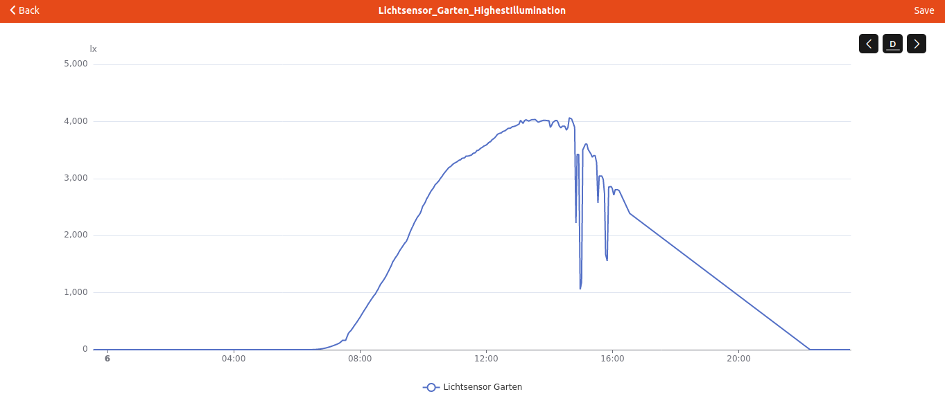

While the CCU2 continued to monitor my light sensor with a time resolution of 1 - 3 minutes…

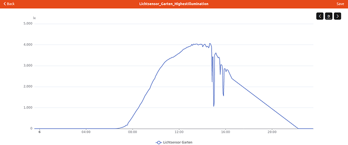

… it did not reach openHAB anymore (refer to the straight line at the end of the graph)…
… even though the communication between openHAB and the CCU was still in place (I could still control devices).
What’s even more odd: The communication between the CCU and Openhab did not stop completely at 4:12. After a short break there was one more update at 4:32, and then after a loooong break another update only at 10:15 (~ 6 hours later).

This is what I found.
