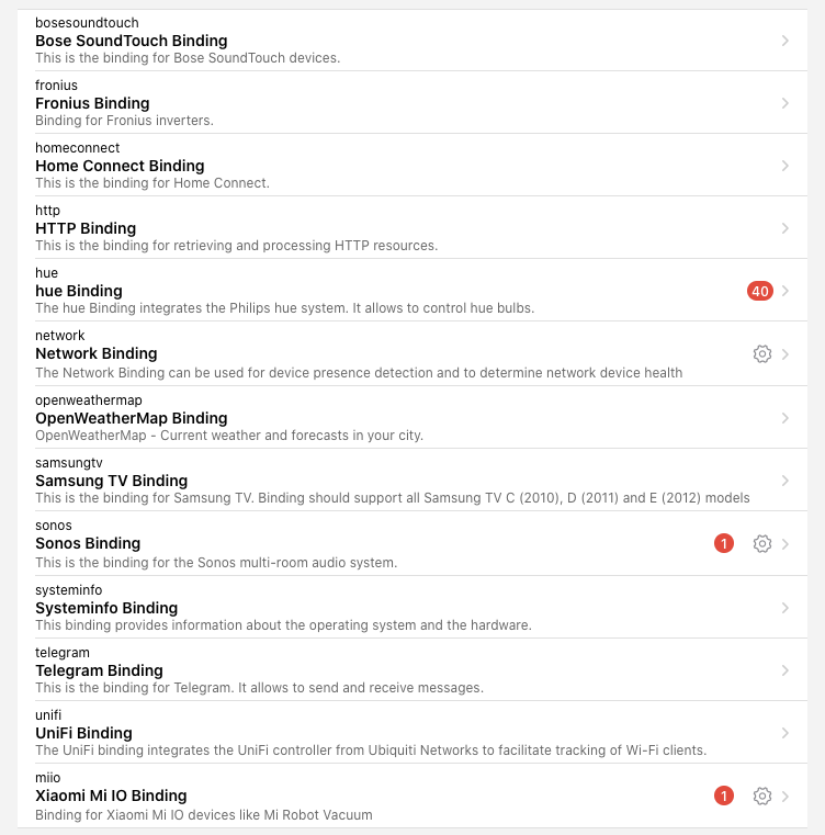

Somehow it does not show in the list - any ideas what could be the reason?
Thanks!
Bindings that are only stored in the addons folder are not visible in the list.
You can check whether it is working in the Karaf Console. Run bundle:list | grep Homematic to get the binding’s state. If it shows “active” then everything is fine. If the state is “installed”, you can try to start it with bundle:start <number>. You will see an error message if it can’t be started.

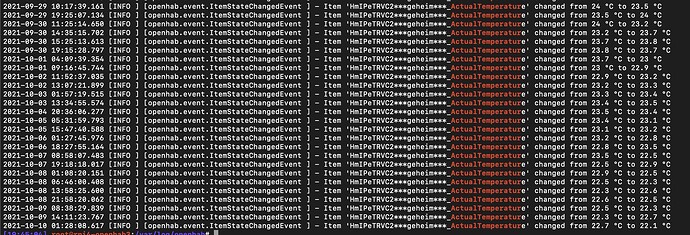

same issue here with Homematic IP Device HmIP-eTRV-C-2 and Openhab 3.2.0 (build: 2473) and Homematic Binding 3.2.0-SNAPSHOT.
In the openhab log i see no errors, but success changed state from CCU. Current round about 24° Degrees. But, Openhab shows always 22.1° Degrees since more than 2 Days. I will not do a restart now. Possible we can debug the current state
 ? It is not a duty cycle issue. DC at 2-3%
2021-10-11 16:15:21.064 [INFO ] [openhab.event.ItemStateChangedEvent ] - Item 'HmIPeTRVC2***geheim***_SetPointTemperature' changed from 25 °C to 25.5 °C

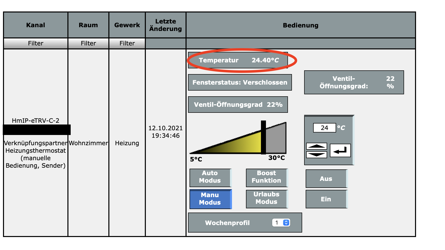

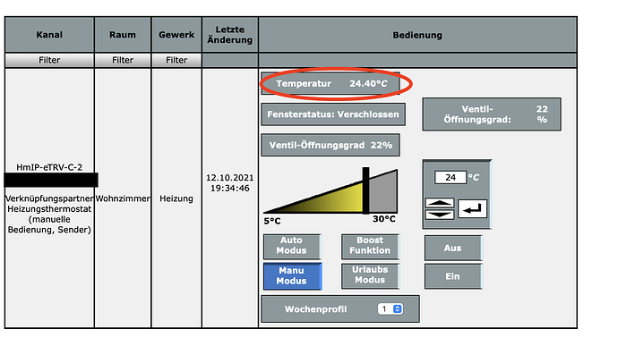

CCU are correct.

Looks like the issue exist since 2 days at night 02:00 am.
EDIT 2

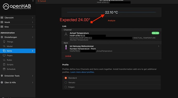

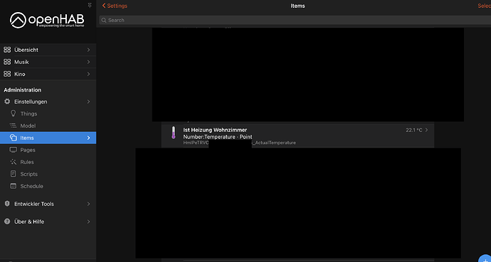

Ahaaa, looks like the ActualTemperatur not updated since 2 days. But
 Why ?
EDIT 3
Mhhh, Openhab reboot solved the issue
