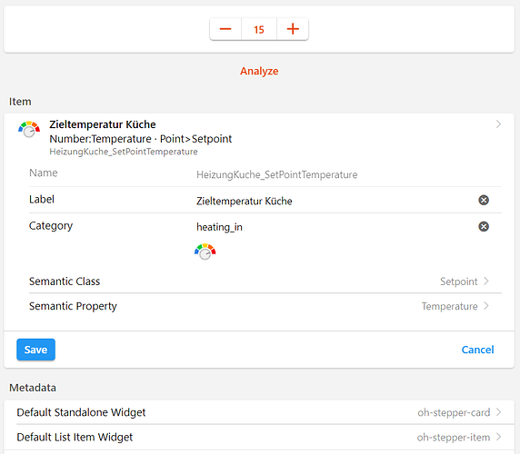

it seems like there is no reaction at all, when I click the increase button on the setpoint item.
Nothing in the log files.

Furthermore, I have tried to directly add the HmIP-STHD temperature sensor and an HmIP-eTRV2 as a Thing and added it as a Point as well as as an item directly, but nothing helps.
Setpoint in the Sitemap is configured, min 5, max 24 and step 0.5
Nothing works.
You can try to change the values directly in Main UI, does this work? Maybe it is a problem with the sitemap.
