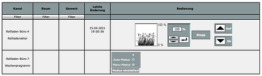

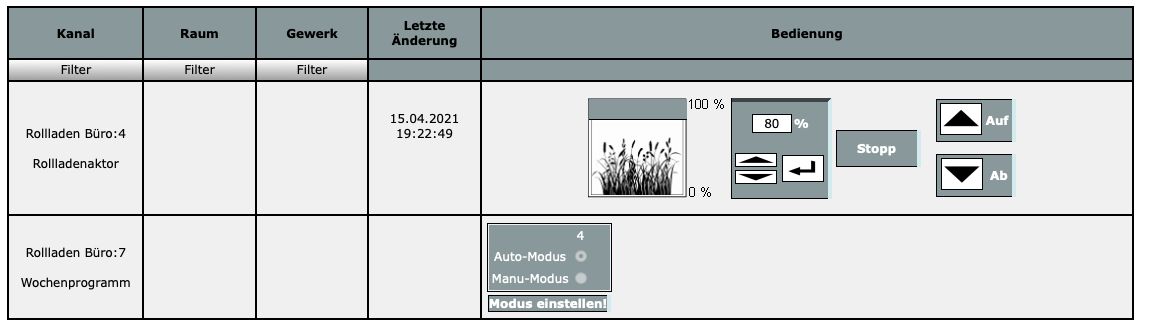

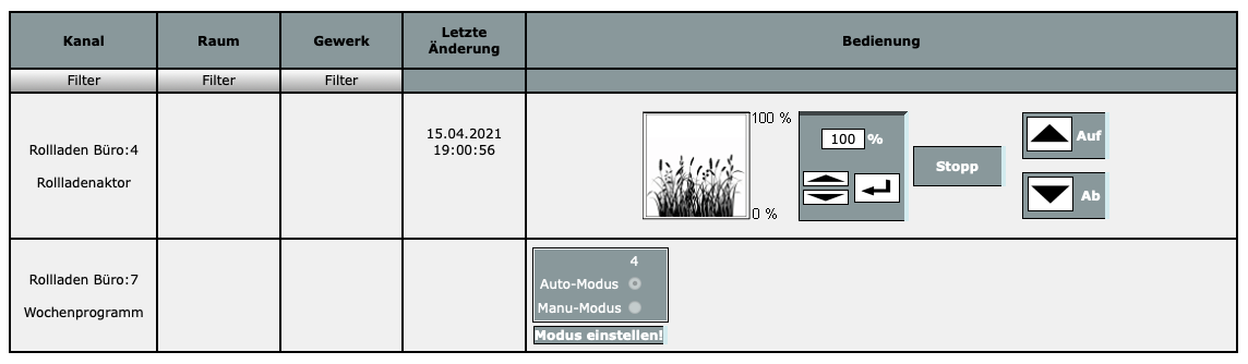

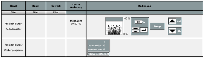

If I change the level via the CCU3 control panel to 80% (for example) the openHAB items are changed to 20% :thinking:
2021-04-15 19:22:46.059 [INFO ] [openhab.event.ItemStateChangedEvent ] - Item 'Buero_Rollladen_Level' changed from 0 to 4
2021-04-15 19:22:46.061 [INFO ] [openhab.event.ItemStateChangedEvent ] - Item 'Buero_Rollladen_Proxy' changed from 0 to 4
2021-04-15 19:22:49.817 [INFO ] [openhab.event.ItemStateChangedEvent ] - Item 'Buero_Rollladen_Level' changed from 4 to 20
2021-04-15 19:22:49.819 [INFO ] [openhab.event.ItemStateChangedEvent ] - Item 'Buero_Rollladen_Proxy' changed from 4 to 20
2021-04-15 19:22:49.822 [INFO ] [openhab.event.ItemStateChangedEvent ] - Item 'Buero_Rollladen_Set' changed from 0 to 20
