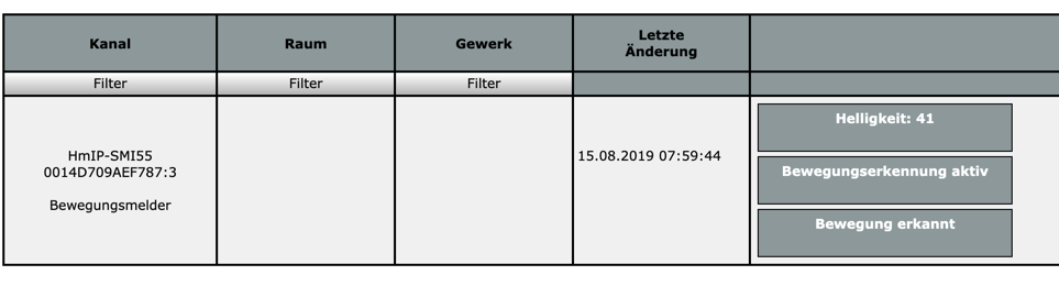

  • HM is receiving status from the HM devices and the status changes in the HM UI

  • A restart of HM → not working
  • A restart of OH bundle in karaf (bundle: restart xxx) → HMIP picked up working again
