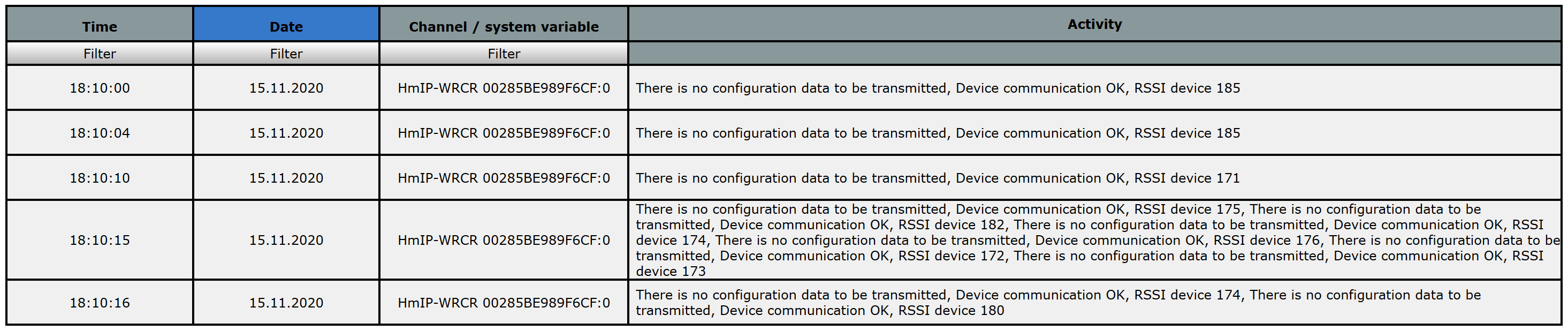

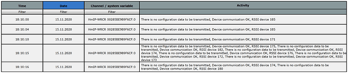

Following @MHerbst’s suggestion, I tried watching the OpenHab logs to check for activity but I couldn’t find anything transmitting, so next I decided to check the Homematic logs and it seems that there’s something wrong there:
