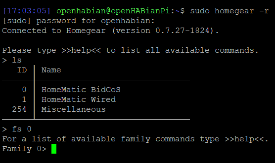

First you should get familiar with homegear.
You need to know what device family your device belongs to and select the appropriate one (fs ).

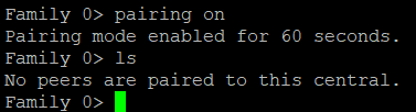

Then start pairing, on homegear console enter , then start pairing on your device.
After this, you should see your devices in openHAB paperUI inbox.
