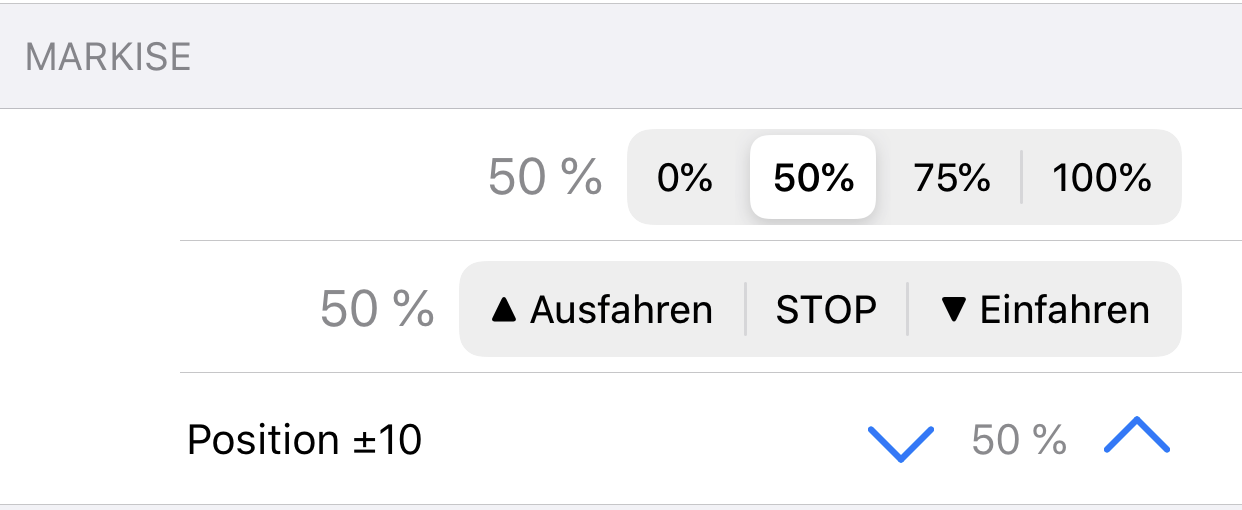

The OH Sitemap is with a Proxy Item, as I also have to invert the values. HomeKit and Homematic does use 100 if the Sunbind is fully open. in OH the value is 0 however. With the ProxyItem I invert the value, in order to show the correct value in the OH Sitemap as well. Not sure this is the correct approach.
I use the inverted proxy as well, but only for charting purposes. For the controlling UI in my sitemap I have chosen to use a mapped button control to quickly select predefined states, with it still allowing for manual control by selecting UP (↑) or DOWN (↓) and pressing STOP (X) when desired.
Shutter
Thats what I use as well, but with different controls (still not sure what the best approach is)
