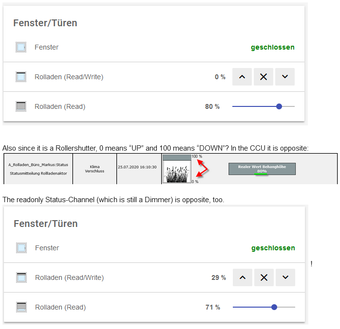

The % of the Rollershutter is wrong updated after “STOP” (its updated to 100 or 0 not to the right %).
It is also not updated when using the buttons in the room…
It IS updated, if I use for example PostUpdate(27)
The readonly Status-Channel is updating right, but it is still a “Dimmer”.? The Read/Write-Channel does not:

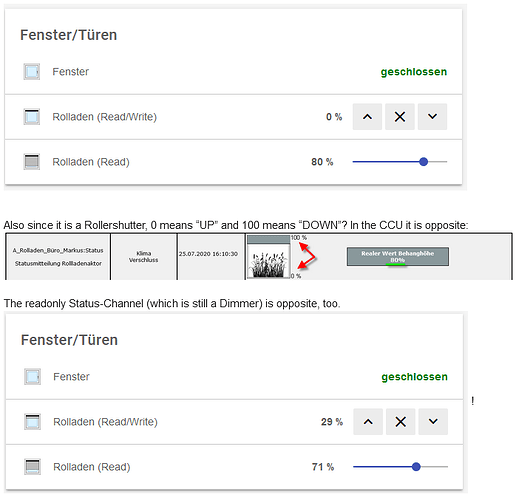

P.S. “New users can only put one image in a post”. I had to put everything in one picture…
If you send a command to this channel, the Level of this channel is set immediately to its target value. When sending a stop command, this level value does not change in Homematic. Your CCU reports the new level (the current level of your blinds/roller shutter) to another channel. In your case, that’d be channel 13.
So OH can never show the “real” level as it just does not know it from this channel the item is linked to.
To send commands to channel 14 and reflect the real level from channel 13, you could use a Proxy item.
That’s bad, I would have expected that the CCU would also send updated values to the LEVEL data point
The binding derives the channel type from its name. Only for LEVEL a “Rollershutter” is used. In my opinion this is OK because the buttons won’t make sense for a read/only device.
Unfortunately Homematic uses the position values different from other Rollershutter devices and the definition within openHAB. In openHAB 0% means fully open, while on the CCU 0% means fully closed. Therefore the values are inverted for the “Rollershutter” type items. The STATUS channel is a dimmer and therefore the values appear inverted.

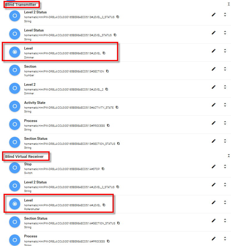

I checked in the CCU again. Its send to the MAIN READONLY LEVEL (in this case 13) because 14-16 are LEVEL which can - for example - be added…
This is a LEVEL, too, but it is recognised as “DIMMER”:
In the meantime, I would also recommend using proxy items.
I will give it a try… :wink:
Thanks for the hint. Currently only LEVEL in channel “Blind Virtual Receiver” is defined as rollershutter. Will add LEVEL in “Blind Transmitter”, tool

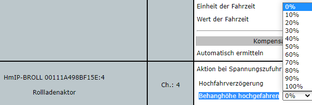

One hint from me:
For BROLL devices on CCU the standard value for fully open is 100%, but you can configure this value with a device parameter on CCU (BROLL firmware 1.6.2); e.g. I set this value to 0% to be consistent with openHAB.
