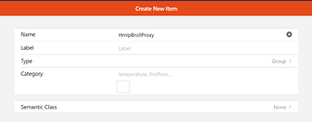

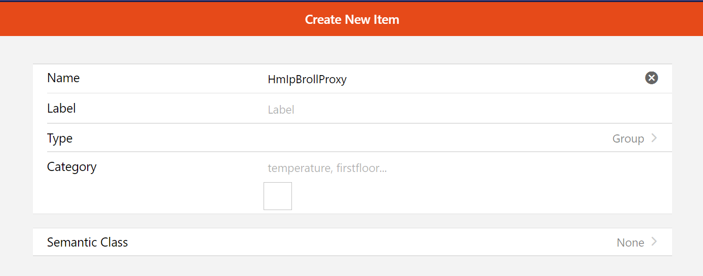

  1. Manually create a group HmIpBrollProxy: So far so good.

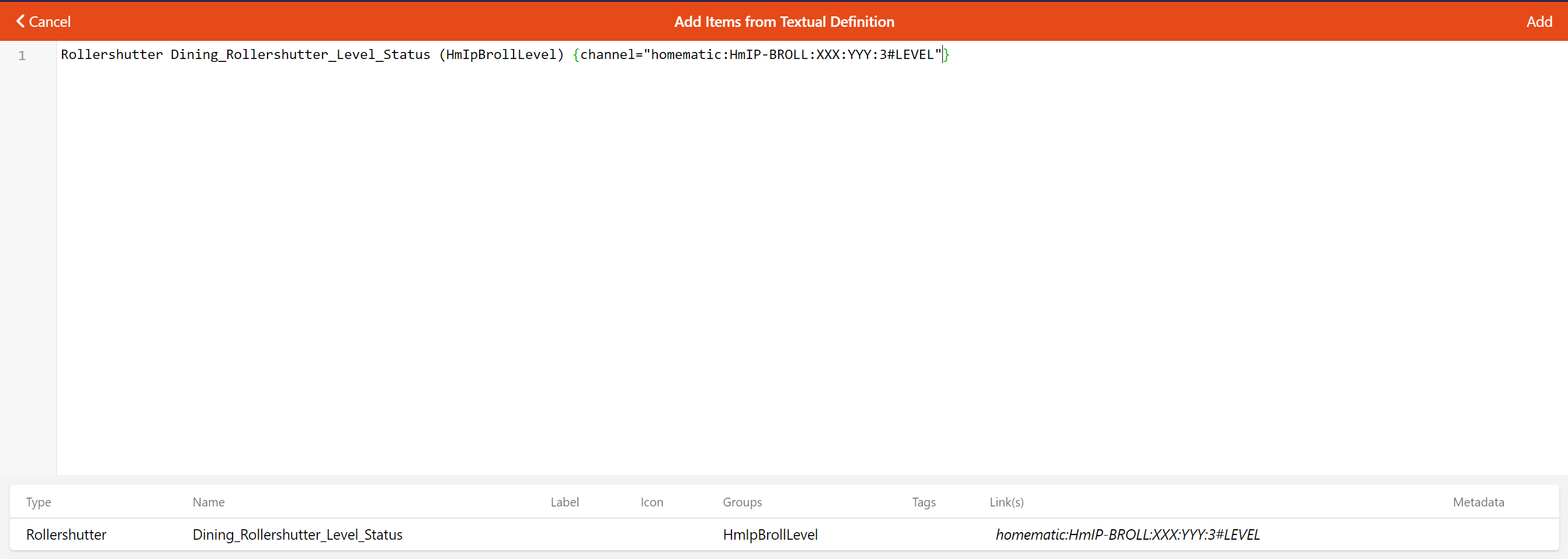

  2. Manually create three items individually via Items → Add → Add items from textual definition.
Rollershutter Dining_Rollershutter_Level “Level [%.0f %%]” (HmIpBrollProxy) {Proxy=‘’ [LevelItem=“Dining_Rollershutter_Level_Actuator”]}
Rollershutter Dining_Rollershutter_Level_Actuator {channel=“homematic:HmIP-BROLL:XXX:YYY:4#LEVEL”}
Rollershutter Dining_Rollershutter_Level_Status (HmIpBrollLevel) {channel=“homematic:HmIP-BROLL:XXX:YYY:3#LEVEL”, Proxy=‘’ [ProxyItem=“Dining_Rollershutter_Level”]}

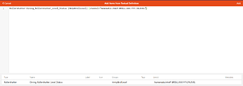

Here’s where I encountered the first problems (I of course replaced the addresses of my device)
When using the proposed code it shows the following syntax error for the 1st and the 3rd item, always around the proxy-code.
Or did I try to include the code wrongly? Replacing the ’ 'with a " " (I thought “well maybe there’s a syntax change between OH2 and OH3?”) and putting a dummy name in between allowed me to create the three items, but this obviously would eventually cause problems down the road.

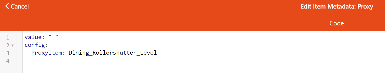

  1. Create the groups HmIpBrollProxy and HmIpBrollLevel
  2. Create the three rollershutter items where *_Level and *_Level_Status belong to the groups listed. You can do this by using the textual definition but removing the Proxy-Metadata.

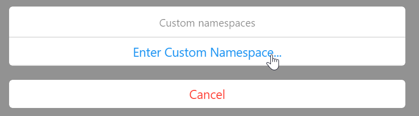

  3. Open items 1 and 3, “Add metadata” accordingly. Custom namespace ist Proxy.
    Seems the syntax is some yaml now… :thinking:
Unfortunately I can’t test by now.
For the python part, maybe you have to add a script instead of a rule? (As said before, I’m not into the concepts of OH3 yet.)
